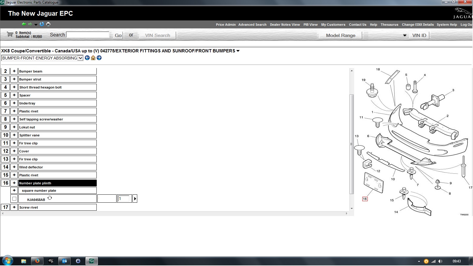

Jaguar solved the problem by supplying a Number Plate Plinth (item 16) in black moulded plastic for the USA square style licence plates:
Like all other permanent licence plate mounting options, the bumper has to be drilled.
Please follow this link New Member Area - Intro a MUST - Jaguar Forums - Jaguar Enthusiasts Forum to the New Member Area - Intro a MUST forum and post some info about yourself and your vehicle for all members to see. In return you'll get a proper welcome and some useful advice about posting to the forum.
