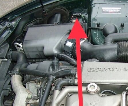

Hiya fellas,
Just been diagnosing a DSC system fault, found the front right speed sensor wire has damage, great, easy fix, but (and here’s my question), where the bloody hell does that wire go to in the engine bay! I follow the wire in the wheel arch but I can’t see where it comes through to the engine bay 😥
Ta

I'm not sure if your coupe would be the same as my converts, but look for a plug on top of the inner fender well just outboard of the air filter.

Ahh, I did see that one, but I thought “naa it won’t be that easy” 😅
Just to be sure, this one?:

Yep, that's it.

Excellent, cheers guys! 👍🏻
