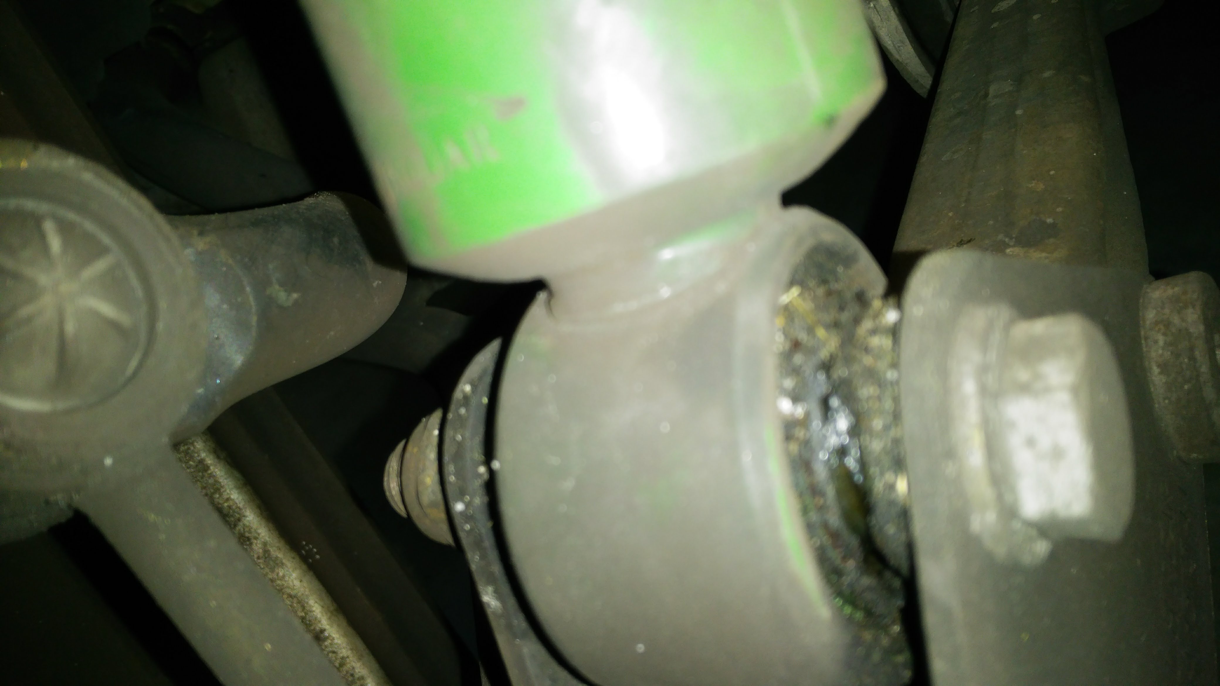

I took a look at my front suspension components and I think I will need to replace the lower shock bushings along with the shock and upper mounts. I have attached some pics. I know the outside rubber on the bushing is pretty much gone, but is that enough of a reason to replace the bushing?

New shocks come with the bushings installed, so take that route.

^^ What he said. Given the age of these cars now, if you are going to take the time and trouble to remove the necessary components to get to the shocks, just bite the bullet and replace them. New Bilstein shocks are available online for less than $100 each with free shipping now from several different suppliers....

Besides, the lower shock part you show is more a joint. It has a plastic insert and takes a lot of load. What you see are the rubber boots meant to keep contaminants out of the joint. These have clearly failed. You can get these joints online for about $20 EA. Shocks are $100, your call. I replaced the joints on mine, but in retrospect, that may have been a false economy at about 100k miles. The bad news is that these joints do not seem to offer a lot of give to alter the ride height. Every bit counts, though, and failed joints like this definitely have some play.
