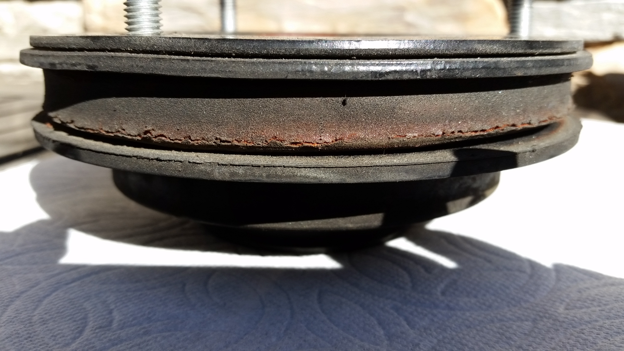

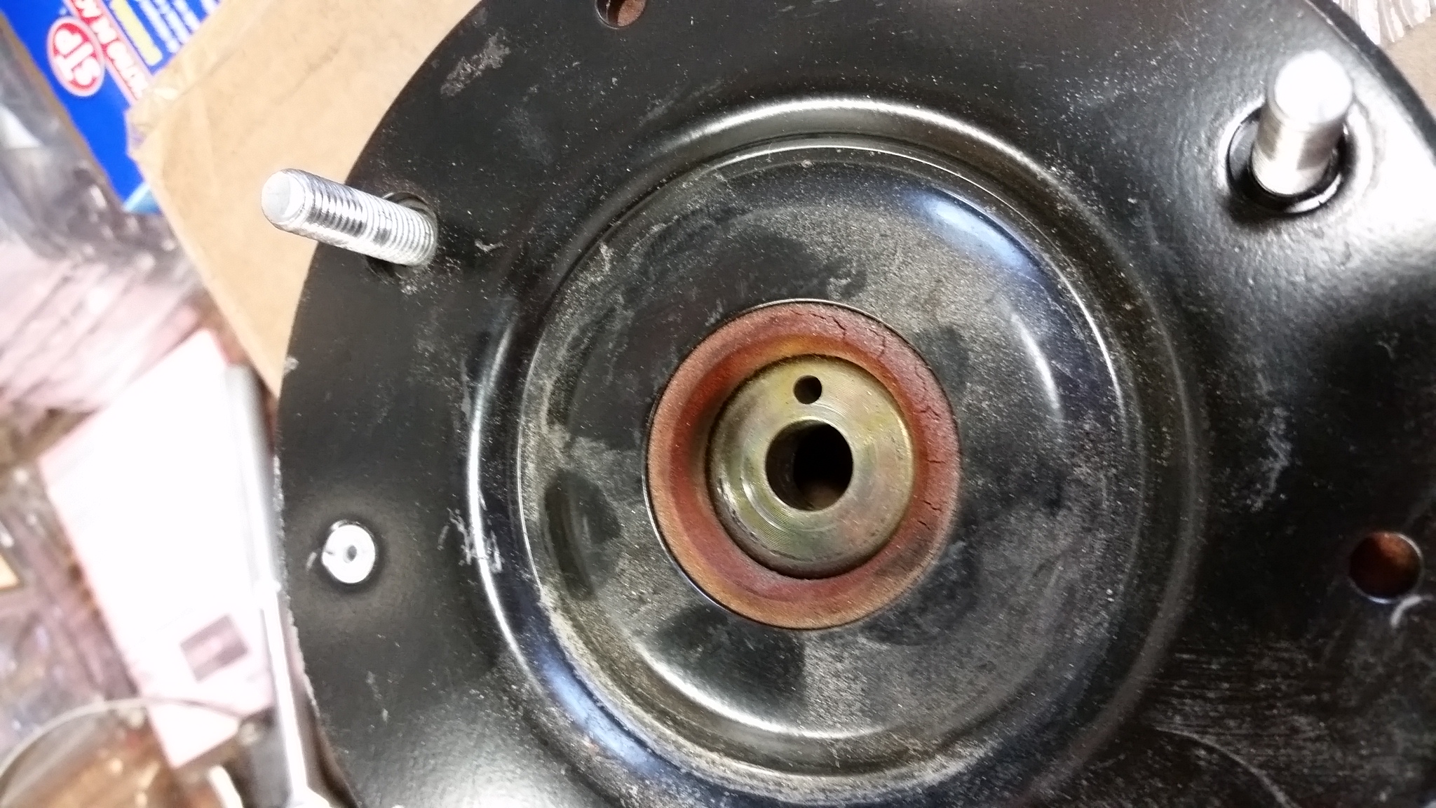

Thanks for everyones input on this. My car has 58,000 miles and is a 2004 XKR. I've had it one year. The front end felt loose in the steering wheel like tires out of balance or some loose connection in the suspension. After much advice, I focused on the upper shock mounts. I ordered the mounts with the polyurethane inserts from Welsh Enterprises. The looseness is gone and the car handles fabulously now. There is no harshness that was a fear of mine. The car has 20" rims so I expect to feel the road and I do, in a sports car way. The car was leaning into corners but no more. I could not be happier with the performance. I've attached side and top pictures of one of the old mounts. You can see the deterioration.
Before, the ride height was 14" on the left and 14 3/4" on the right. Now it is about 14 7/8" on both sides. Stock is 15.5" so I don't know what would bring it up but I like the lower look.
