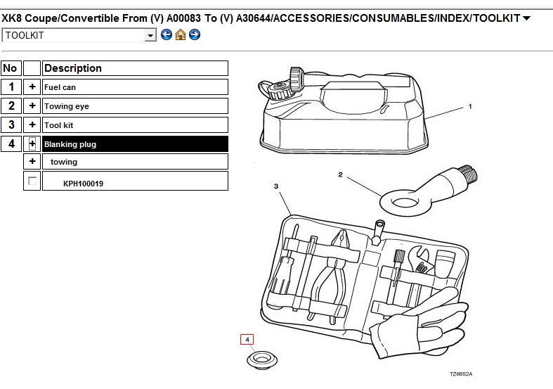

Does anyone know the part number for the plastic plug that is used to cover the hole where the towing eye screws into at the front of the car.
I have had a search around but cant find the part number and Jag says it doesn't exist, but it does as my car had at least one before I dug it out.
Old May 9, 2013 | 05:22 PM
Likes: 17,016
See Item 4:
I'd like to find one of those tool kits - Item 3!

Originally Posted by GGG
See Item 4:
Thanks Graham, I spent 10mins on the phone with Jag parts today trying to find this, they didn't believe it existed.
I dont think my car could be towed with this as the threads have all but rusted away. My plan is to inject the cavities in the front beam with rust converter and then with cavity wax to try to slow the rot.

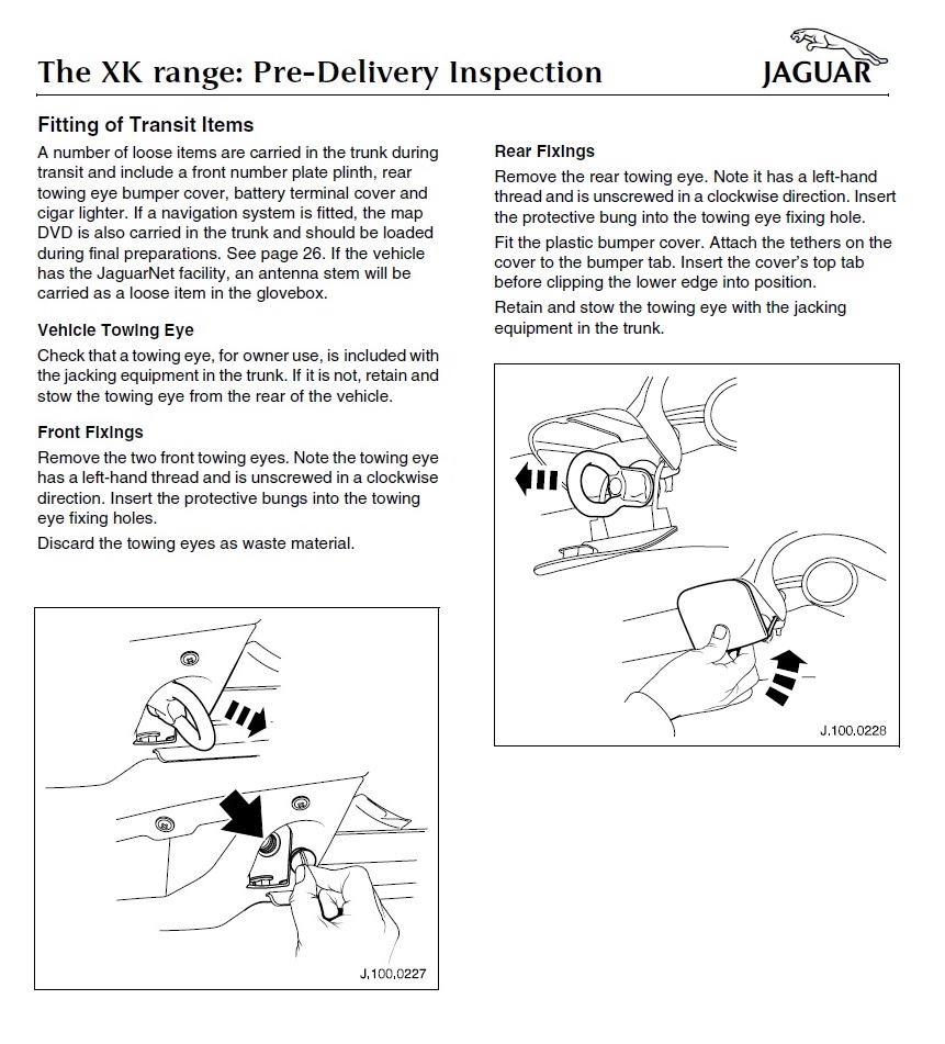

According to the Jaguar PDI (Pre Delivery Inspection) Manual, the Towing Eyes are removed during inspection and preparation for sale. One should be stored in the tool kit.
The screw-in plastic bungs are regularly missing.
I had my last 2001 XK8 towed onto a flat bed twice in one week using the front towing eye when I was in denial about a failed Throttle Body!
