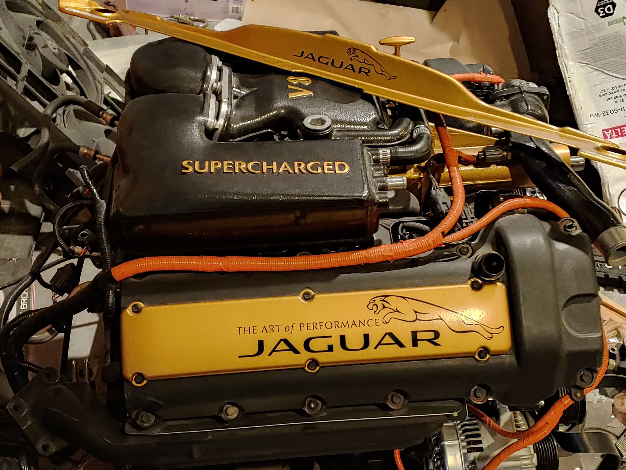

You wouldn't believe all the things I've done to this car I'm soon to put a video of my engine rebuild on a 28000 miles pulley 6% overdrive and 16.8% lower aj27s engine swap. I replaced all the bushings to polyflex including shockmounts I replaced fuel pumps, radio header unit with android based flip top, all for shocks & springs to 1.5 red H&R lowering I put the lightweight high flow paragon impact bar, grantleys modified front led lights, 4 row intercooler with Bosch Highflow Inter cooler pump new rims, tires, rear window, brakes added nameless preformance cats, x pipe soon I'm going to add light weight seats, I just got to figure out which pump is primary and pair the second pump with a weaker pump... 2x walbro 255 seem to have decreased my cars preformance.
Engine I rebuilt and painted
Fully upgraded 2001 XKR
