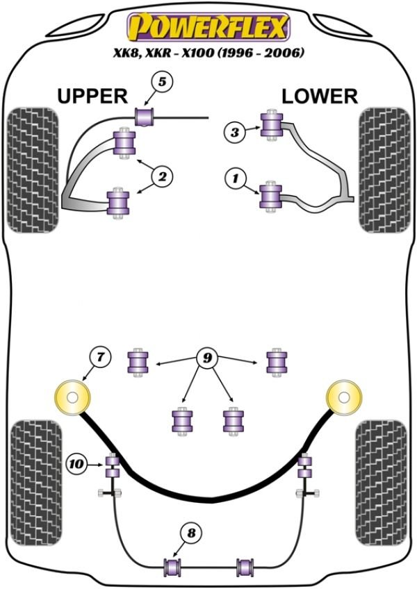

Just curious, has anyone installed the full compliment of Powerflex ploy bushings front and rear? While my car is down with an immobilizer issue I’m planning to replace all bushings, Bilstein B6 dampers, H&R springs, and Wayne’s strut mounts. I’m going for better handling and firm ride, think 911 level of stiffness. I don’t want jiggle your teeth out rough. Some members have done their upper arms but I wasn’t able to find feedback on doing everything.

Are you guys doing everything? even the rear beam (#7) and axle (#9)?
How is the NVH?

I elected to not do #7 and #9 because I didn’t want to drop the rear subframe. I can’t report on ride quality yet until I fix an immobilizer issue, hopefully next week.

Closing out this thread, I did the full front in poly and the rear sway bar links and bushings. Along with Wayne’s front mounts, H&R springs, Bilstein shocks, ball joints, tie rods, and sway links. Handling has been dramatically improved especially body roll, it’s not a 911 but it’s a LOT more fun to drive. On everything but rough roads I think the ride is very smooth, but it can get a little harsh over seriously broken pavement. Overall I’d call it very well controlled but not harsh. Given the choice I would do this again.
