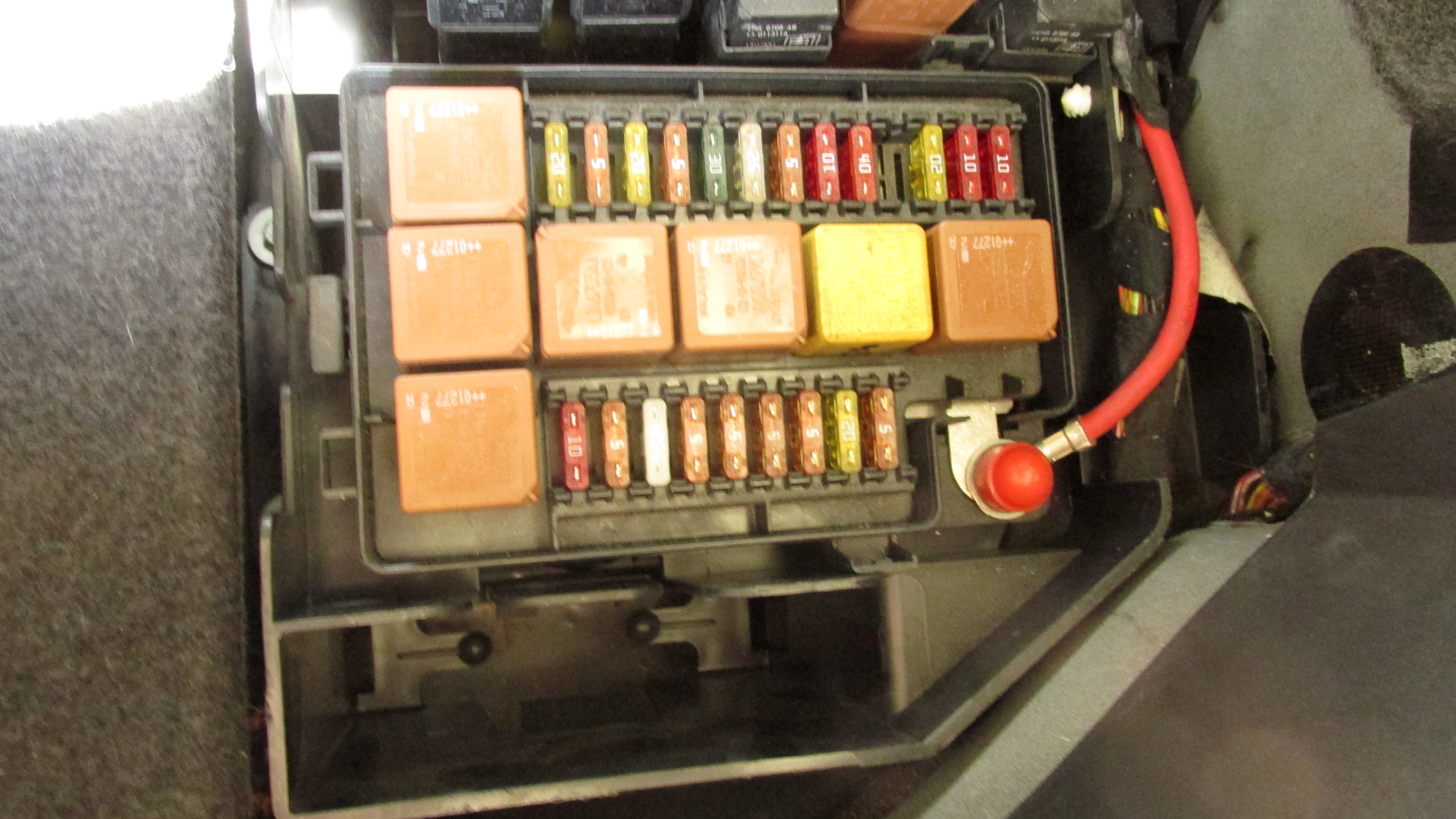

These are 3 fuse boxes. driver's side passenger side, trunk.
None of the diagrams I have for my 2002 XKR match and I am trying to figure out what fuse goes where ??
1 and 3 are the passenger side, 2 is driver's side and 4 is trunk. Current problem is that side mirrors inop as are passenger side windows ?? Probably more till I sort them out !!!

Try this one. I can't get a match on the LHS of that fusebox either; they seem to have got the guide out of order. The door control module is the only 25A fuse in there. Should be F15, but sat in position 11.

Thanks for the download. The fuse charts in the book do not match the number of fuse openings I have in mine. See photos verse diagrams. Also, what is the number 1 position on each fuse location ?? Appreciating your help. I am going to look up the info for an 01 since my build date was September ??

Use a flashlight on the fuse box and look to the side of the fuse and you will see the number embossed for the position.

Had to also use a magnifying glass to find the tiny numbers. Never knew... Thanks for the tip. Still unable to adjust side mirrors... Cannot seem to locate that fuse or control relay ?

There is nothing specific about the fuses except for something about each of the door fuse modules that are 25A. they are fine. Seems strange both are out ?? Any other ideas or suggestions ??
