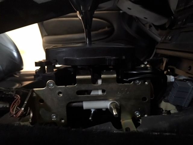

Got problems with getting the gearshifter in P, when shifting Linear switch on my xkr 2004 cabriolet.
The first problem was that D and the right side of the J-gate would not engage or illimunate. Park, Reverse, and Normal lighten up, and i could reverse the car.
I hav bought and now try to replace a new linear switch, but working with this i cant get the gearshifter up in P, so the drive peg and sliding block on the linear switch could not get in the right position. Normally i´m allowd to get the shifter in park when i engage the brake pedal, but no i can´t get the shifter to the Park position whatever i have tried. With engine on, and press on brake pedal, and tbattery reconnected, and connectes - but gearshifter would not get in Park . Any tips?

Adjust the cable linkage under the center console to get the forward movement you need to latch it into the park position.

I have loosen the cable...... Now it looks like these pic. Did not get it into P with cable on...... and now the linear switch are taken off and out of position? Therfore need to get the shifter in P position for put it together again....

remove the little plug with the torx-like inlay on the left side of the j-gate, above the "2". use a suitable screwdriver and turn anti-clockwise. once you have it out stick a small screwdriver shaft in the hole. this will release the mecanical lock and you should be able to move the gearselector.

After a lot of tickeling and fickeling for some hours, erasing the related diagnose faults, and adjust the linear switch and the cable linkage, suddenly all went well ! Hurra!
