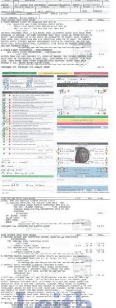

This is the image of the diagnostics and repairs done so far
and here's a link in case you can't see it well:
http://oi45.tinypic.com/24xp3x4.jpg

This is almost the same issues that I am having. Can some one please tell me how to inlarge the pics. My threat is the cat has a mind of its own.

I just the car home from Greenville tonight and I am going to check to see what new codes have been set. I think that I have a moisture problem that has cause so sensor issue. Drove thru flooded roads and heavy down pours. Will be up dating my thread in the morning. I did get it to enlarge and used the old reading glass. Thanks Jim

to enlarge the pics open from the link provided, when that window opens, click the view pulldown at the top of the browser window and select zoom - you can now enlarge to a readable pic.

Regarding the valve cover gasket, the dealer inspection said there were severe leaks, so the gasket should be changed. If the leaks are outside, you would probably smell oil, If the leaks are inside at the spark plug seals, this could be contributing to your misfire problem.
Regarding the ABS faut, certainly cleaning the sensors will not hurt. Generally if the fault comes up when you are moving, the sensors or sesnor cables are likely suspects. If the fault comes up when you first start the car it could be nothing more than a weak battery. Have your battery load tested for free at Autozpone or Advance Auto. If the fault comes up at a standstill, it could also be the ABS module, which has a known problem with a bad solder connection at the connector. Search the forum, this is not too hard to fix yourself if you can solder.
Regarding the transmission fault, I would suggest getting a second opinion from an independent Jag repair shop.
