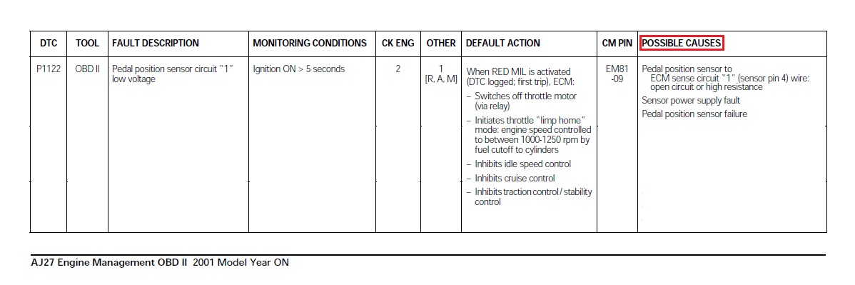

P1111 is not an error code. It shows the OnBoard Tests have been completed. You will always see this one OR P1000 (OnBoard Tests not completed since last memory clear.

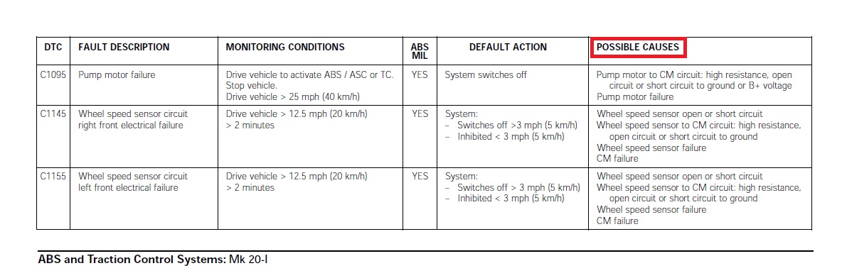

For the others, here's the Possible Causes from the Jaguar DTC listing:

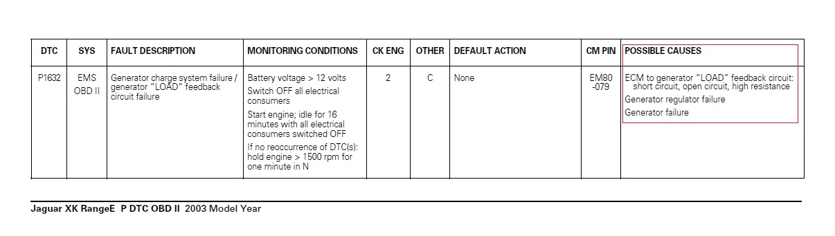

Have him confirm P1632 as it's not listed for your MY.
Your mechanic appears to be going directly to worst case scenario before checking and eliminating other possible causes. He may be right, but you're the one paying.
Attached Thumbnails Gearbox fault error whats the next step?-c1145.jpg   Gearbox fault error whats the next step?-p1122.jpg

The c1095 indicates open circuit from the ABS module to the ABS pump. This is repairable, and in fact a fairly easy diy, but check on ebay and you will find several offers for $50-75.
The wheel speed sensors hardly ever fail, but they might need cleaning. The connecting cables do fail from flexing, and may need replacing. Your mechanic wants to thouw parts at the car without knowing exactly what is wrong.

With respect to the P1632 code, he stated that the code was in the Jaguar manual and not in the normal ODB list of codes. He mentioned that it read something was corrupt...I need to get the correct verbiage.

............. With respect to the P1632 code, he stated that the code was in the Jaguar manual and not in the normal ODB list of codes. He mentioned that it read something was corrupt...I need to get the correct verbiage.............
I use the Jaguar manual for codes. The extracts I posted in #2 are for the 2002MY.
P1632 is not listed for that model year but is listed for 2003MY:
I know US dealers use model year differently from the actual factory date and your 2002 could be a 2003MY specification.

So the mechanic was trying to twist my arm and tell me that absolutely the ABS module was causing the previous codes and my tranny would fail if I did not get a new ABS module......HOwever, in his testing the Gearbox fault warning never returned or even the Check Engine light...both never recurred. SO I drive the car over to my normal jaguar guy who is adjacent to a transmission shop. The ASC warning remains no other warning appeared while driving.
They checked the codes and found that P1122 and P1632 were still hanging around. The codes for the RF and LF speed sensors did not return. With that, the transmission guy is saying the ABS module is not the issue (which I knew) BUT he is saying that the throttle body may need to be replaced. He quickly referred me to the jaguar guy.
