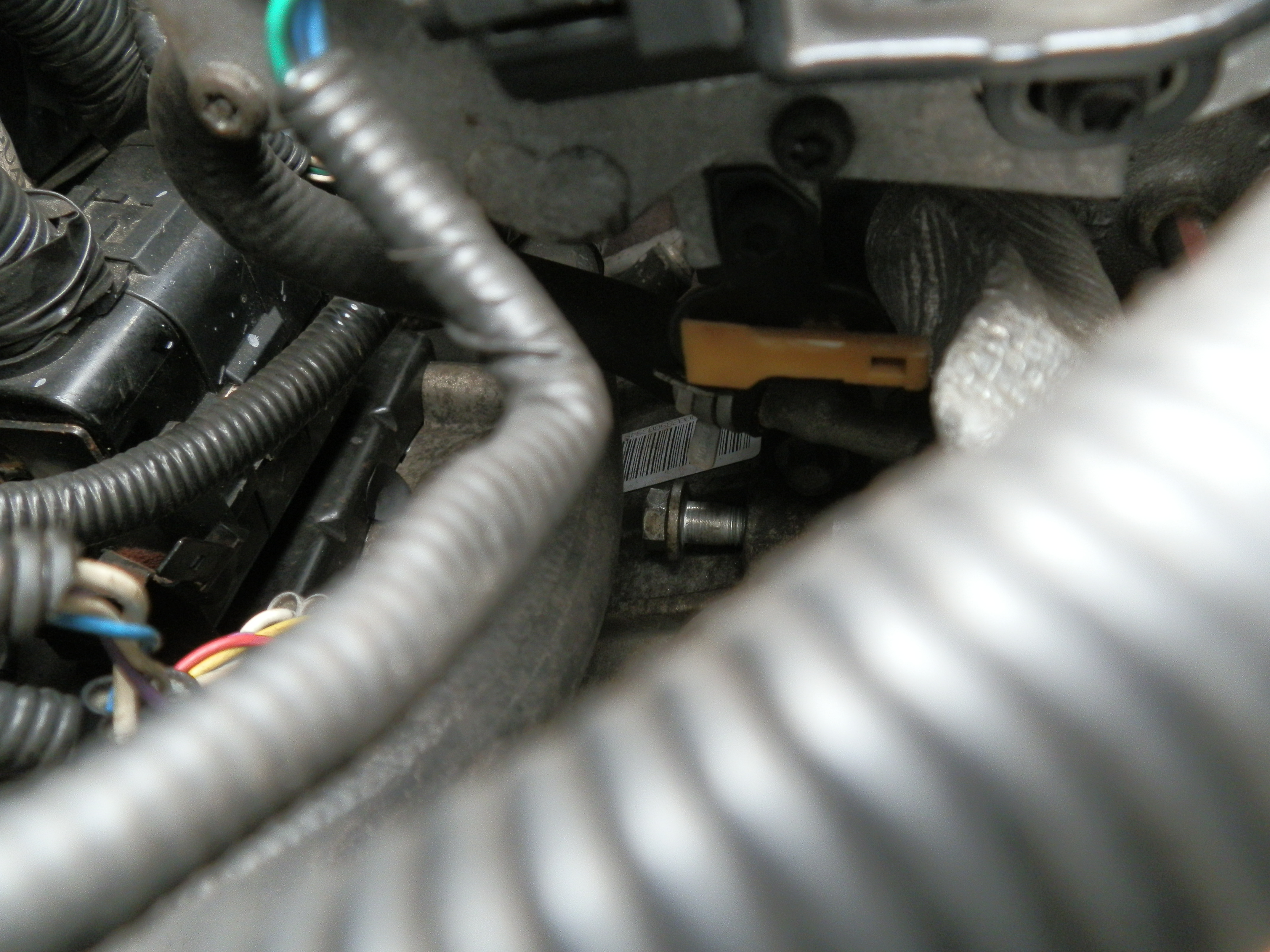

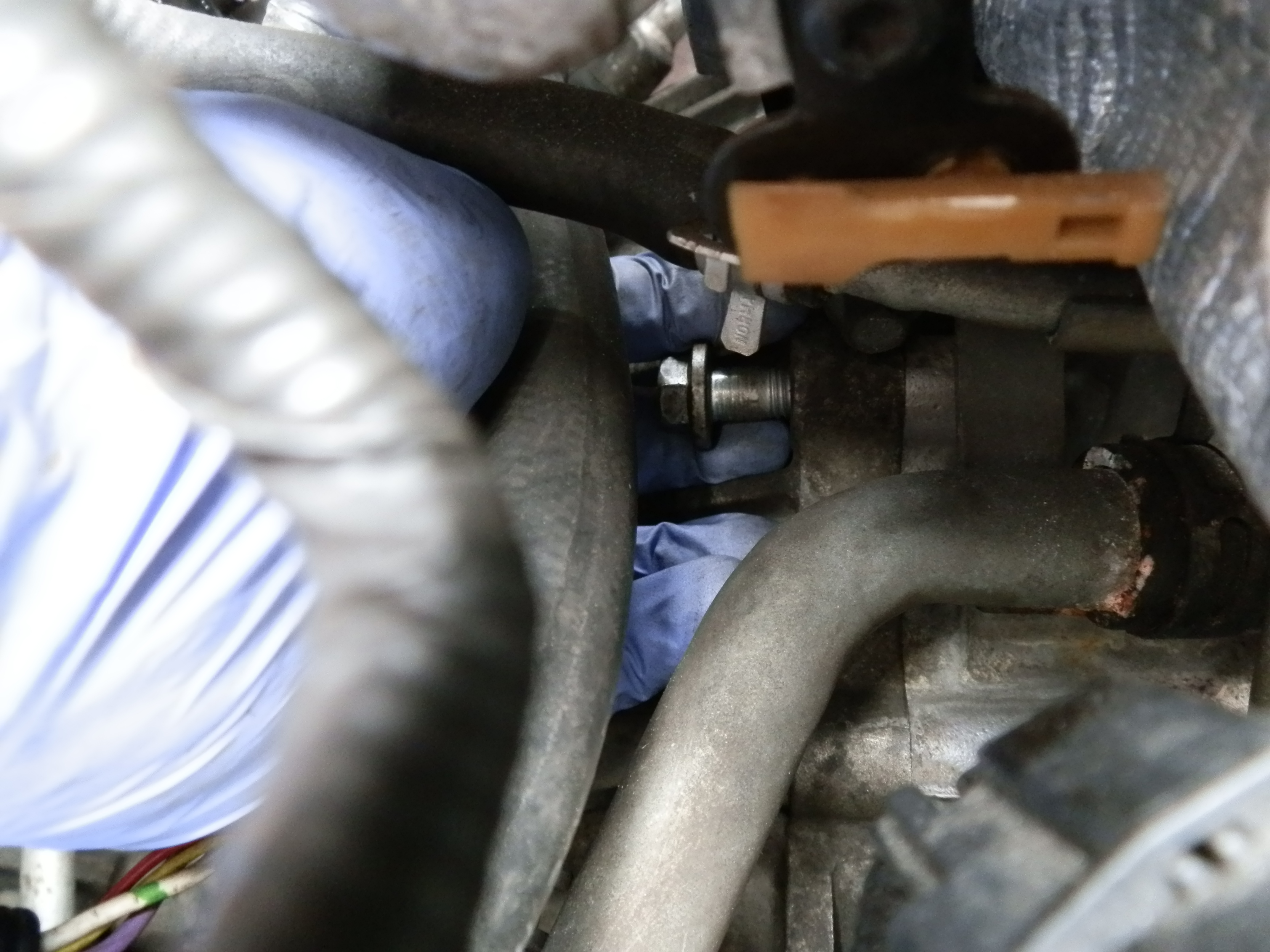

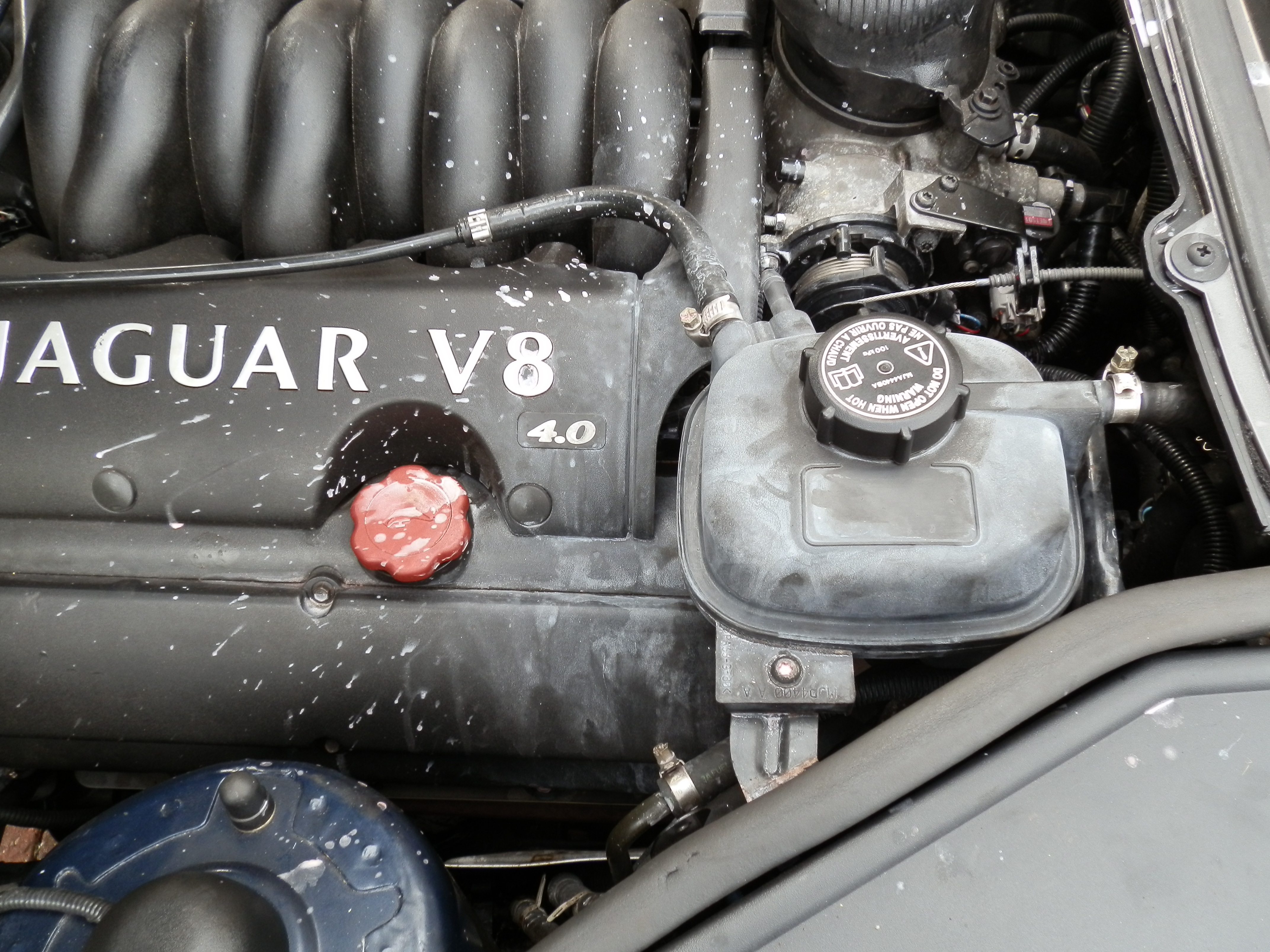

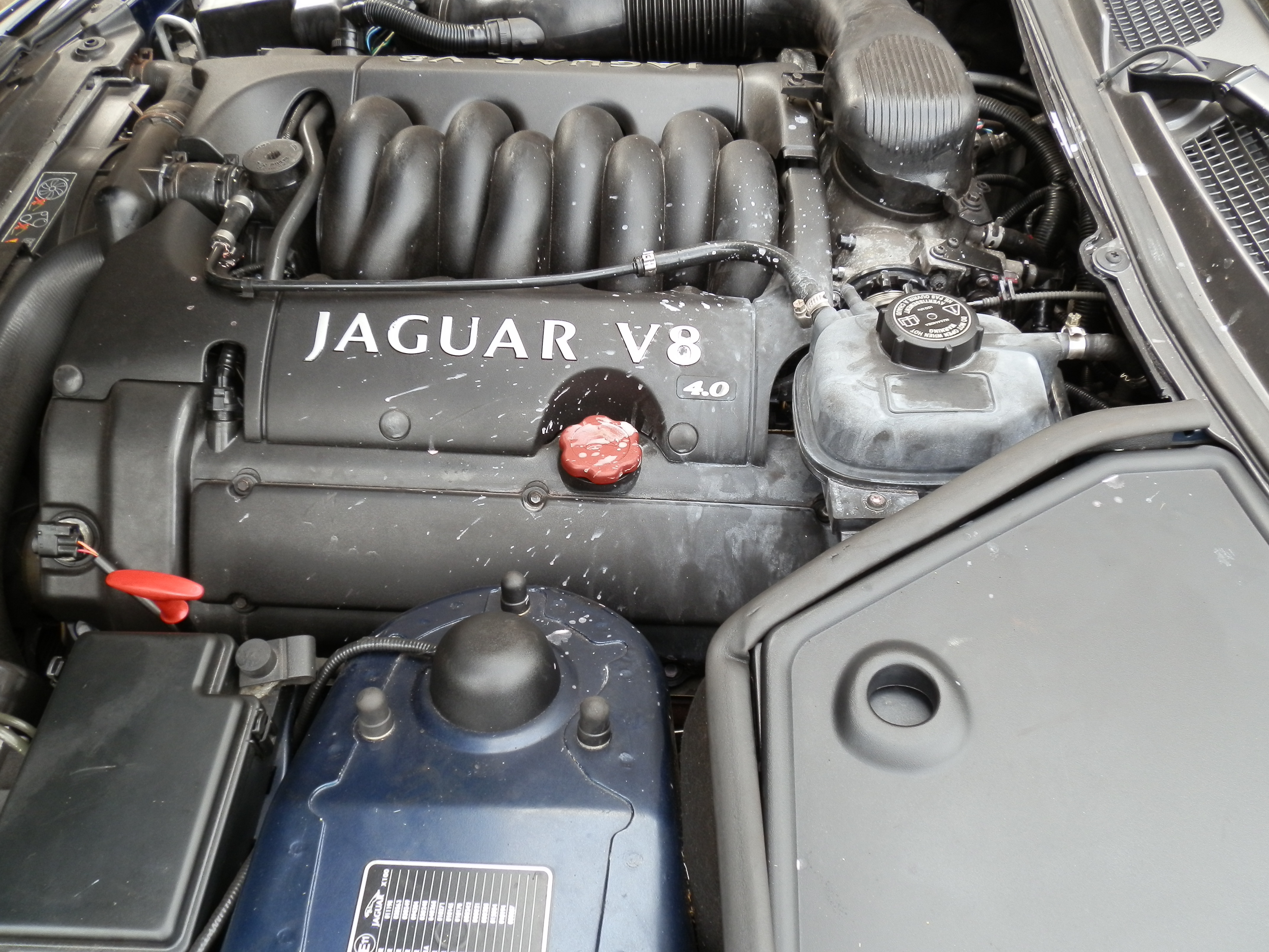

Today Sunday 16th, took TB1 for another test drive. Found that its now bumping into first gear same as the original box, no further forward. So I have to contact the gearbox shop again tomorrow as its still under warranty ( 3 months ). Here are some pics of how it was returned to me.

Very disappointing and sloppy; not a confidence builder in terms of the work they've done on your transmission.

Just a word to the wise - make sure you keep those photographs - if the repair people don't perform such pictures will be useful in any county court action(always a last resort of course)

Arty, my heart bleeds.
No excuse. It's not like the loose bolt isn't in an obvious place, and anyone with any pride would at least have cleaned off the coolant (der-what's under this screw cap?)
+1 on batroute's comment. Little consolation, but I'd be gunning for a full refund and look elsewhere.
Wouldn't have these guys knocking knots out of planks of wood to make a***holes for rocking horses.
Easy to say, but don't give up - at 63k this girl isn't done for...

To be fair guys, as I said this is how the car was returned to me, but it was at two garages. The first garage fitted the first replacement box which did not work, then they fitted the second box from the gearbox shop, thenIit was driven back from the first garage to the gearbox specialist by their staff. It was there a month and thats the condition I got it back in. So between them that mess was made. The loose bolt and the electrical problem, whether it was the plug, coil or me re routing the harness and securing it lies firmly at the door of the gearbox specialist. Just my observations to date, I will contact them Monday to report the bumping issue and see what they say. Thanks for the support guys
And the bumping into 1st gear?
You are too nice...
