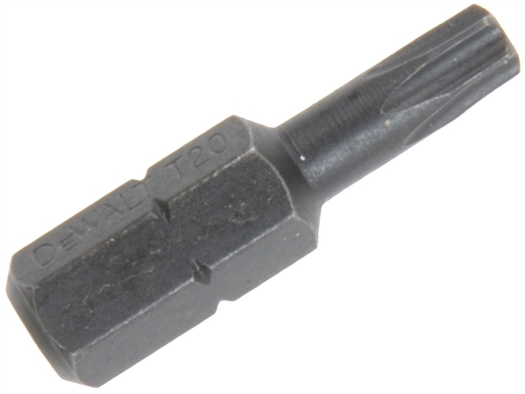

This is all a bit from distant memory but …………….. I managed to get the front ones loose by using a Torx bit like this :
and a small open-ended spanner (wrench ??) to grip it and turn - not enough room for a proper socket wrench. I had to use a fair bit of heat before it would move. You then have to bend it a bit to get the "open end" wide enough to pull through the hub but it is thin steel so can easily be bent back again.
