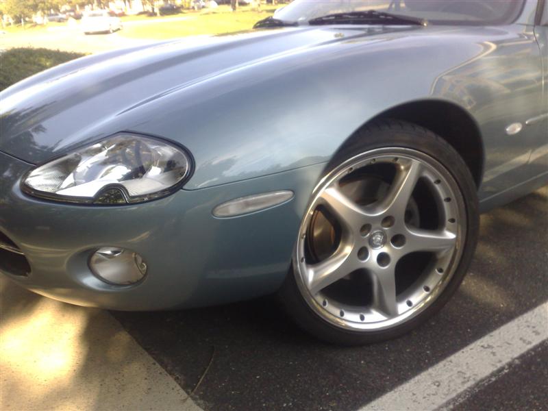

I finally made the jump and replaced the lenses on the front marker lights (at the bumper) Taking a kitchen knife to OEM parts is a bit daunting but I think the results are pretty good.
Before
After
With clear repeater

Per your request:
Originally I tried to purchase them from Geoff @ Adamesh. He was very helpful but he only provides either non illuminated reflector units or LED units as complete assemblies. I am not really ready to go all LED so I opted to retain the standard lighting and go with the lens replacement.
The lenses were purchased through eBay(UK) from XKZ Zahran Limited:
http://stores.ebay.com/xkz-zahran-limited__W0QQrtZncQQ_sidZ42066942QQ_trksidZp4634Q2 ec0Q2em14?_trksid=p4634.c0.m14.l1581&_pgn=1
The lenses were received in less than a week and were well packaged with clear instructions an a high quality adhesive.

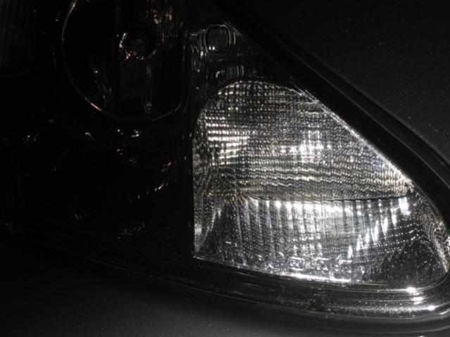

The The first step is getting the existing units off of the car. The light Assemblies are held in place with two spring clips. To remove them simply push the Assembly left or right and pull the free end away from the bumper. The lamp holder is then removed with a quarter turn.
The next step is the one I was concerned about most. The instructions say to use a kitchen knife but I attempted to use a heavy duty utility knife to no avail. The kitchen knife is required as a rigid blade is key. Starting at one end place the tip of the knife between the lens and the housing, I ended up chipping small bits off until I could get the blade inserted between the two pieces. After that simply slide the blade between the tow parts and about a third of the way through it will pop off.
What you end up with is pretty messy as the two parts were well joined at the factory. I ended up using a fine grit sanding block to clean up the edges. (The yellow reflection in the following picture is from the edge of my sanding block)
After that the lenses are simply glued into place. Once the glue dries apply a thin bead of clear silicone caulking to the seam on the back of the assembly to weather proof it.
There is a noticeable flange on the clear lenses and overall it appears a bit bigger than the original amber lens but other than that the look is pretty clean (note there is no text or lettering of any kind on the new lenses - no place for wax to collect )
Installation is as simple as reconnecting the lamp holders and pushing the assemblies back in.

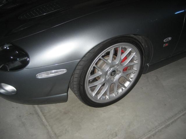

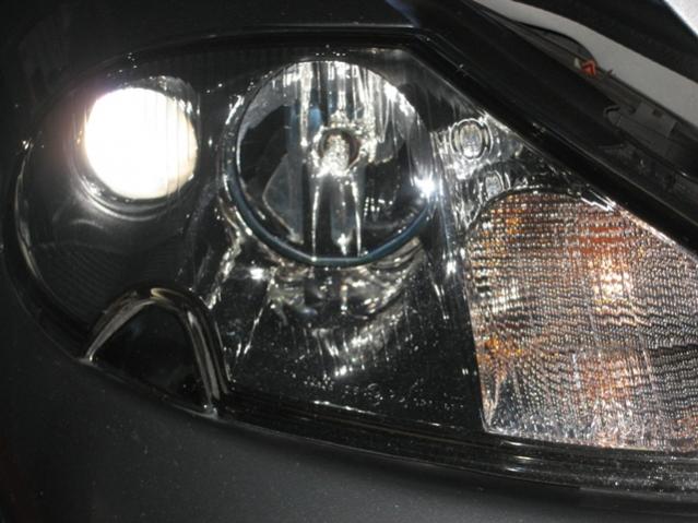

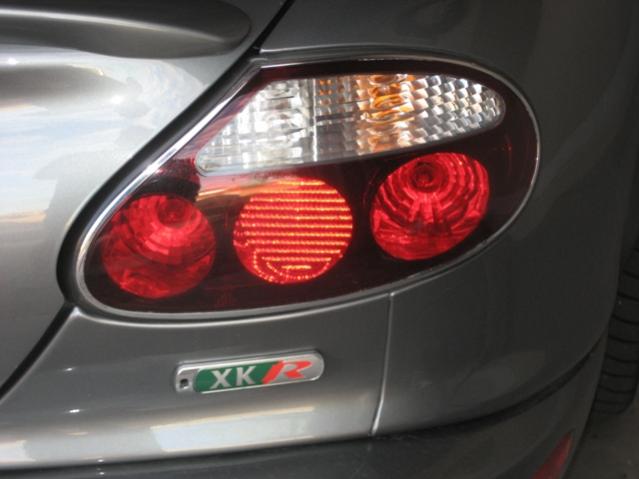

New chrome bulbs installed, they are not as bright but they sure do look better.
