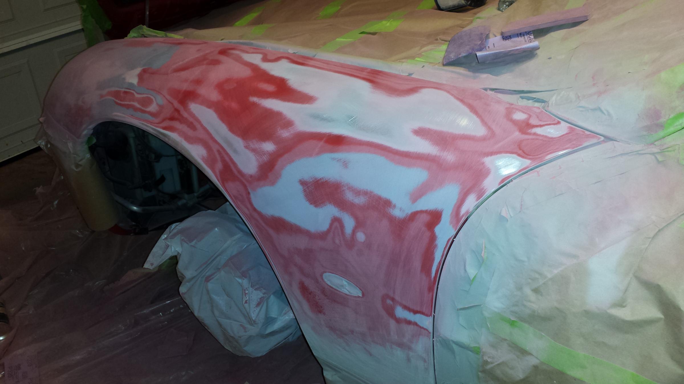

I began by refinishing my dorchester gray window trim and color matching
my mirror covers, and just went full bore from there. Delaminating clear on my left front fender was next, I then noticed my front tires were down to cord on the inside.

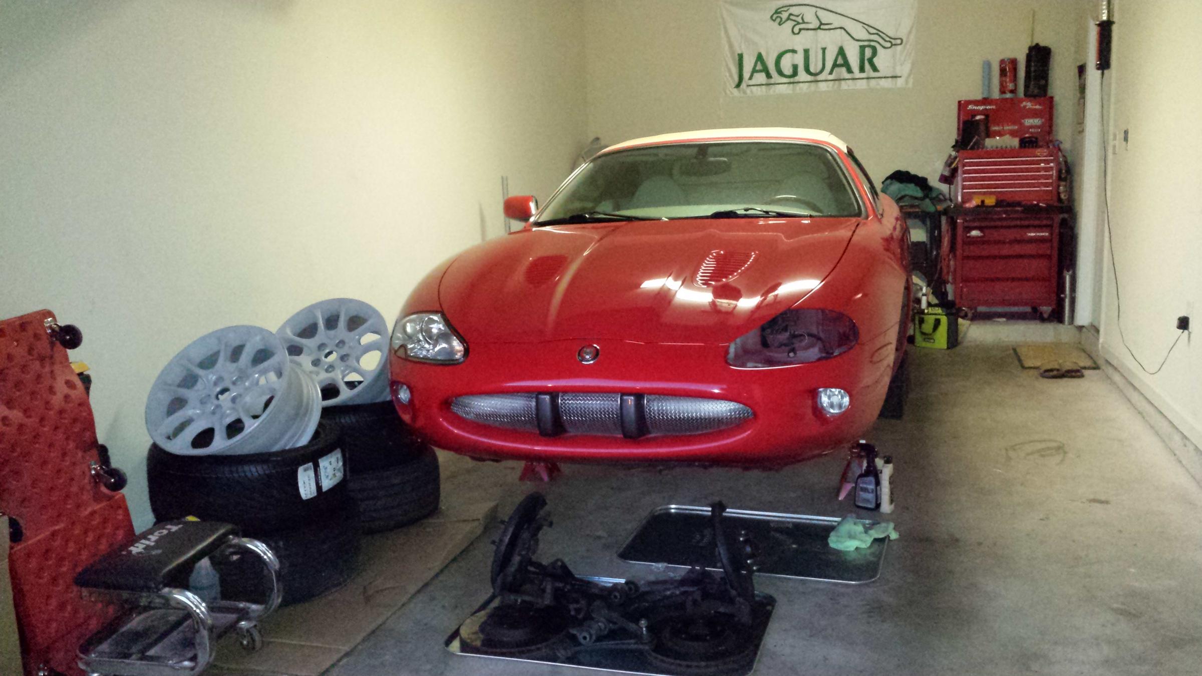

At this point a clear decision was made, instead of just replacing affected
parts, I decided to do complete suspension, upper and lower, with urethane bushes, upper and lower ball joints, stabilizer end links, tie rod ends. lowering springs, new tires, yeah, the full meal deal. The rear will receive the same treatment. Yes, I still have head gaskets to replace, I'll make that my final project.
Here's my thoughts, why not make this the "XKR" Jaguar should have done from the start. I feel this car deserves more than the factory allowed, so
this now is MY vision.
The wealth of info shared on this forum has saved hours of probable frustration. The paint was easy, the suspension came apart with very
little drama. I found the upper ball joint boots torn, and all except the lower shock bushings looked good, but all must be replaced to suit my vision, and so I began acquiring all parts, whether

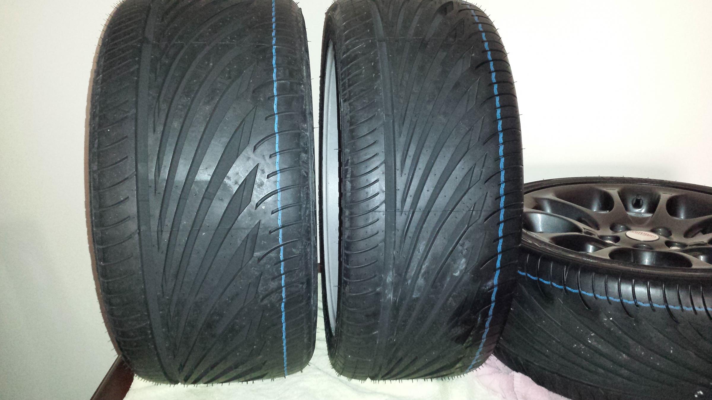

Vredestein Ultrac Sessanta tires: (can't wait for the comments
on these!): 255/35ZR 18 front/ 275/35ZR 18 rear: Ebay, killer price!!

At this point, upper control arms are complete, repainted and ready for install. The lowers I am taking to the machine shop this weekend, then
back home to repaint and install bushings, upper shock mounts get delivered tomorrow.

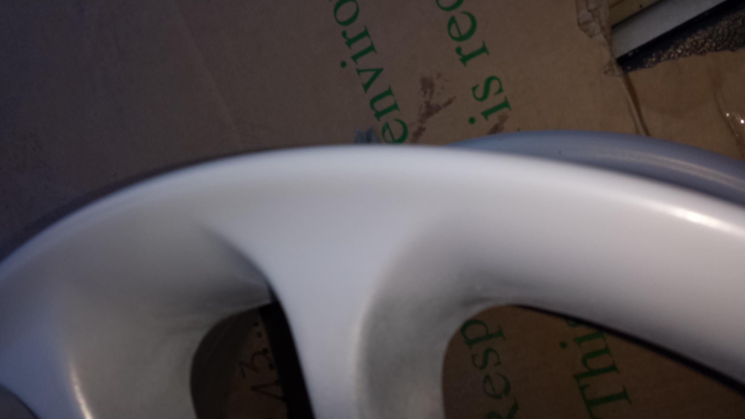

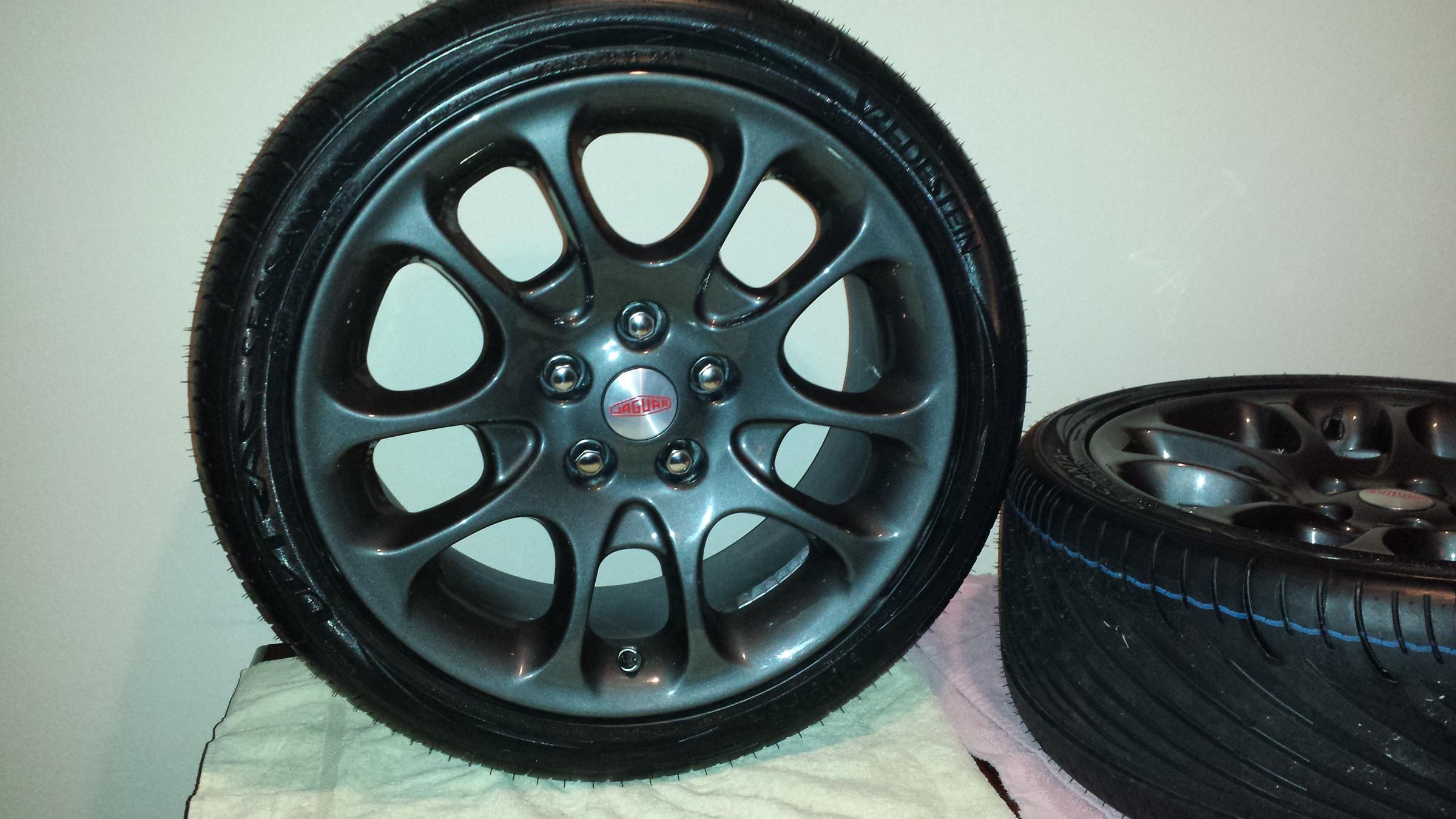

I have repaired the curb rash left by the previous owner on my Double Fives, then repainted and cleared, yes, even baked the paint in my kitchen oven, now hard as powdercoat, let me know how ya like the Dbl 5"s in Dorchester gray.

Oh man. I'm picking up my double-fives today from being refinished and repainted their factory silver. I'm now having regrets after seeing yours powdercoated much darker. I love it.

Car looks and I'm sure will feel great on the road. Your double fives look terrific, almost the same color as mine look after one day of driving (brake dust). It would certainly go a long way toward eliminating my morning ritual of wiping down 4 wheels.
Nice job on the paint and the wheels look great with the body color.

The Phoenix Red and Dorchester Gray paint was supplied by AutomotiveTouchup.Com The clear is SprayMax 2k Glamour High Gloss Clear from Eastwood Co. I also used Eastwoods epoxy primer and urethane high-build sandable primers. Now the kicker, all from spray cans, yes c a n s!! New technology, easy use, professional results on a budget. Man, I sound like a commercial, but its true. I have done custom auto painting for many years, hate foo-foo cans, but this stuff works.
The wheels are done the same, all from cans, just baked each step to harden and quick cure. 275-300 degrees for 45-60 minutes. I had the tires mounted at Butler Tire in Atlanta, they were amazed to hear these wheels were painted at home and not powdercoated. Time will tell how well they hold up.
The upper shock mounts arrived from Terry's Jaguar Parts this afternoon, quick ship and great price, original equiptment parts for under 2 bills each, nice!
Should be done with front suspension in next week or 2, then on to rear, powerflex bushes all around, H&R springs and new rubber also. Hope to start motorwork sometime early summer, Eurotoys being my choice for head and supercharger porting.
I'm beginning to see a pinpoint of light at the end of the tunnel, looking forward to the end result. I see my little red cat as a fine Brit that's being "shaken, not stirred", I'll post more pics as work progresses.
