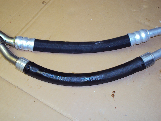

Originally Posted by Jon89
What model year did Jaguar upgrade at the factory to the new-and-improved oil cooler hoses in the XK8?
Not sure when the changeover occured, but you can inspect the ferrules and see the difference. The new is on top in the photo, the old is below. Thanks to FlaSteve for this photo.

From: Raleigh, NC
WhiteXKR,
Have the new-and-improved oil cooler hoses definitely put an end to this problem?

From: Arlington VA USA
I have not heard of a reported case on a forum, but this would be a better question for one of our techs to chime in on.
