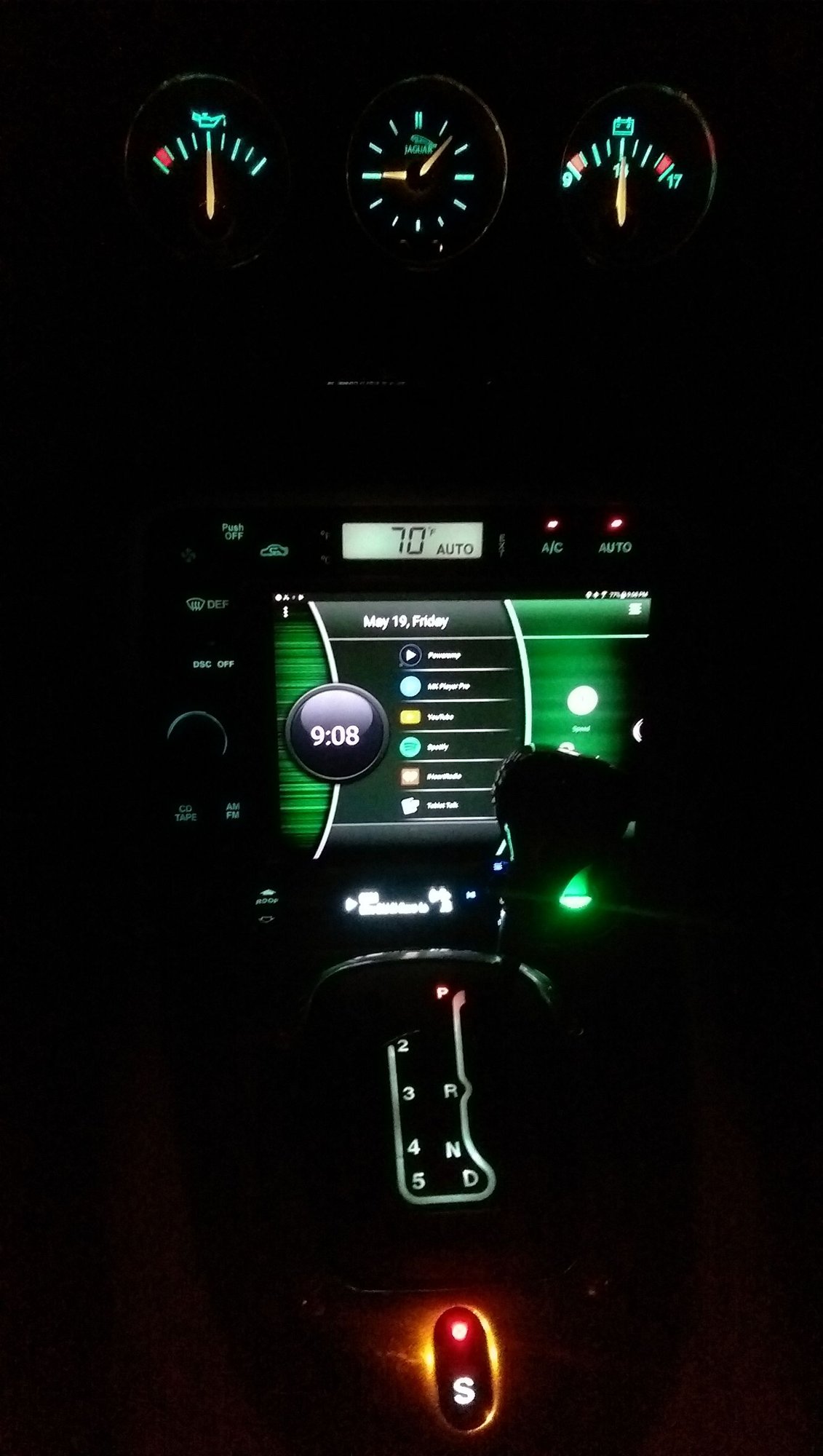

Motorola TK30 mounted in coin tray along with USB charge port next to it (exposed coin tray is a dumb idea anyways). These Bluetooth connect and power a Samsung Tab S2 8", for Navigation, videos, and music going through Jaguar Alpine amp. Its attached by a hidden high power magnet, so it can remove or fold down to access behind panel controls Wifi hotspot is in glovebox, powered by Jaguar's optional accessory socket. TK30 also connects to phone at same time. Phone works through Jaguar phone connect and audio mute no matter source playing. CD changer is switchable to use itself or TK30 with Tab S2, since both sources use CD changer input.
