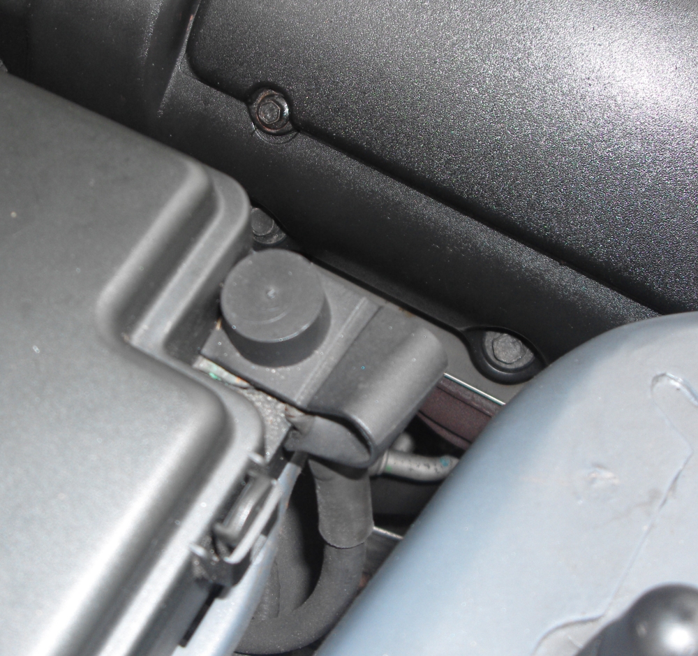

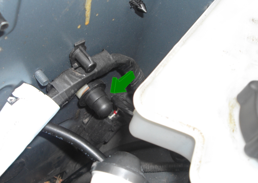

I'm no expert (and there are many here who are) but I think it would be worth 10 minutes or so with a simple voltmeter to check whether all the volts in the battery are getting as far as the engine compartment. May be different on LHD cars, and later cars may be different to my 1997, but with the engine running, check you have about 14 volts across the battery terminals. Then, with the negative probe connected to a GOOD earth in the engine compartment, measure voltage at the main terminal on the fuse box :
and also at the connector in the "false bulkhead" on the rear right (on my RHD car it's where the brake servo is located. Photos show both sides of this stud which is covered by a rubber cap. If you have, or don't have, a good 14 volts or so at both these places it may help to narrow things down a bit.

P.S. Jim is 100% correct about ground points but ............. to avoid any confusion and a potentially VERY expensive bang, the two places in my photos are BATTERY POSITIVE.
