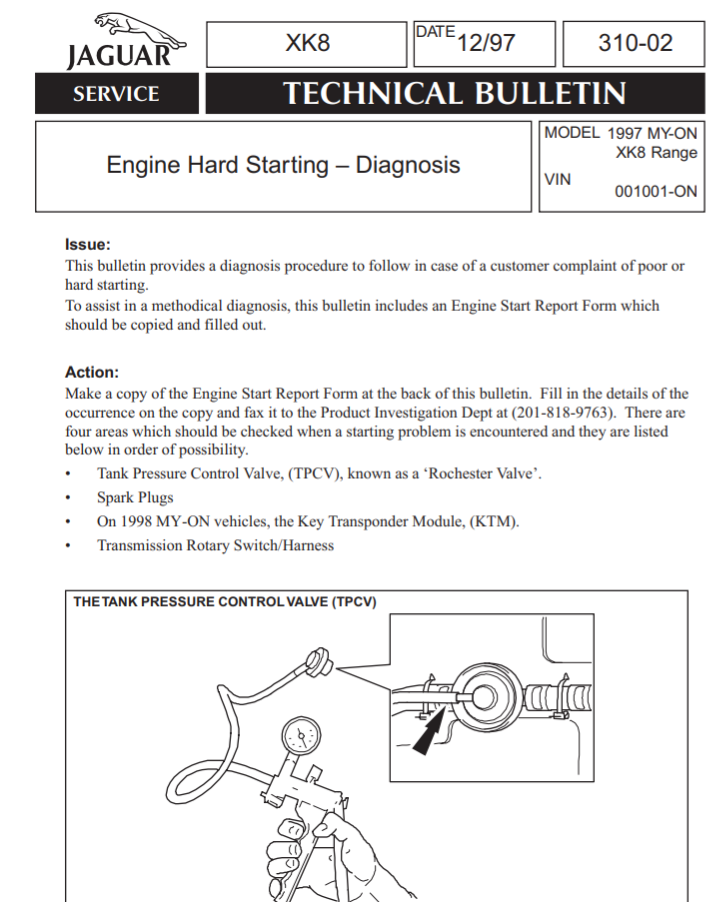

Another update, another bad part!
Finally following Technical Bulletin 310-02 on hard starting, I followed the directions for testing the Tank Pressure Control Valve, (TPCV), aka Rochester Valve. As soon as I pulled the vacuum line off I could smell the gas vapors. It couldn't hold any vacuum at all. I believe this vacuum line goes directly to the intake manifold, so it provides a direct path for gas vapors to get to the engine unmetered.

So far this looks solved, and the car has been starting easily for a few days.
Following this technical bulletin I ended up testing the tank pressure control valve (TPCV) and found it open from the vacuum line directly to the tank side.
Both my purge valve and my tank pressure control valve seemed broken. Replacing the purge valve didn't fix it, but replacing the TPCV as well did.
It's a really strange effect that releasing pressure on the tank before starting didn't help anything, so I'm thinking gas vapors leaking through these valves were building up somewhere, but how or where I can only speculate.
TSB 310-02
