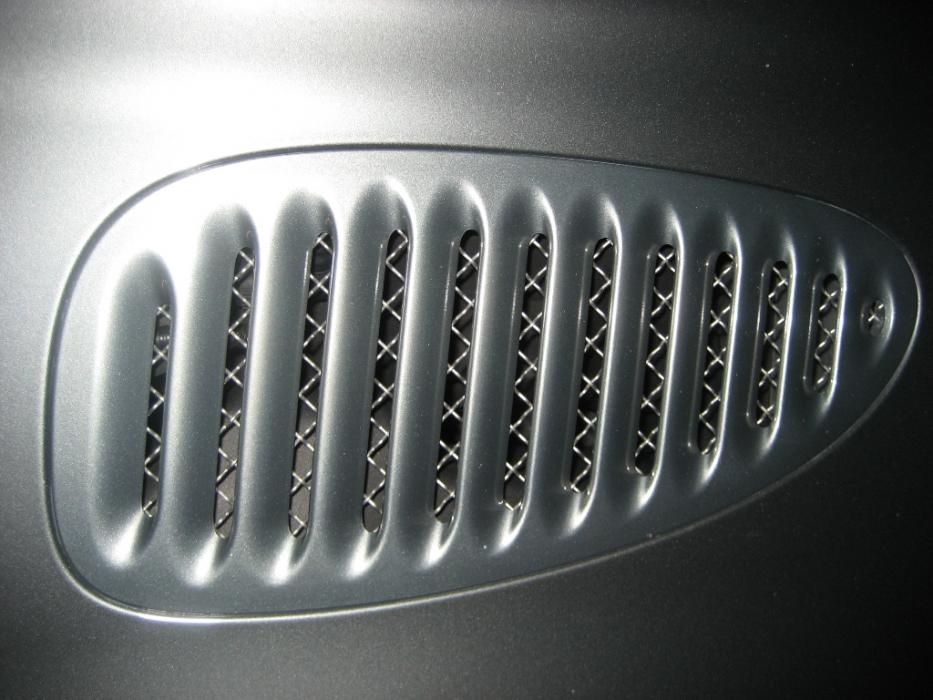

I took a bit of a different route. I thought the original design was lacking something so I added a mesh insert behind the factory louvers. I purchased a sheet of SS wire mesh on eBay and cut them to fit. IMHO $25 is not a bad investment for the subtle detail it adds.

Nice. I think the SS replacements are too flashy; however what you did is pretty classy and I like it...probably helps keep leaves out too.

Doug (RCSign): That's what I thought too, it always looked unfinished to me.

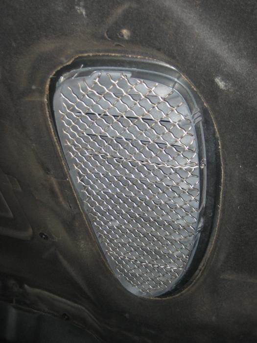

Doug (SeismicGuy): I cut the mesh a little over sized so when I installed them into the vent I used needle nose pliers to bend each cut wire which essentially pressure fit the material. - Originally I was going to use split rubber tubing around the expose edges but after test fitting the mesh it seemed unnecessary. See photos - (Please no comments about my hood insulation, it is next on my list to replace)
For added security I took a single piece of wire from the mesh and made retaining pins that cross the entire vent width wise. I drilled small holes in a place where the crossing wires would not be visible from the exterior and inserted the retaining pin through both holes and bent each end. Two pins per vent just in case.
The heavy gauge mesh was key here as it is very rigid and I have no rattles at all.

Thanks Marc. The use of the safety restraint wires is excellent. Do you happen to have the link of who sells these types of pieces of mesh?

Unfortunately no, I do not know a vendor; I got lucky on eBay and found some material similar to the grill but it is a bit larger gauge wire.
I have had these in for quite a while and if I knew Paragon made these that is the route I'd take - and still may for a more finished look. This wasn't the easiest thing to do for numerous reasons, one of which being the fact that I had to do all the cutting with a power tool. It may be easier for some but it was my first experience using a die grinder

XKRacer--Maybe you could work out a group purchase on these? The only thing I would prefer is the way the mesh is oriented in MarcB's installation (look at his pics).

That is why I still had that particular grille hanging around, I did not like the way the grille looked, I prefer the grilles 'squares' points to be 90 degrees to the horizontal of the louvres.
