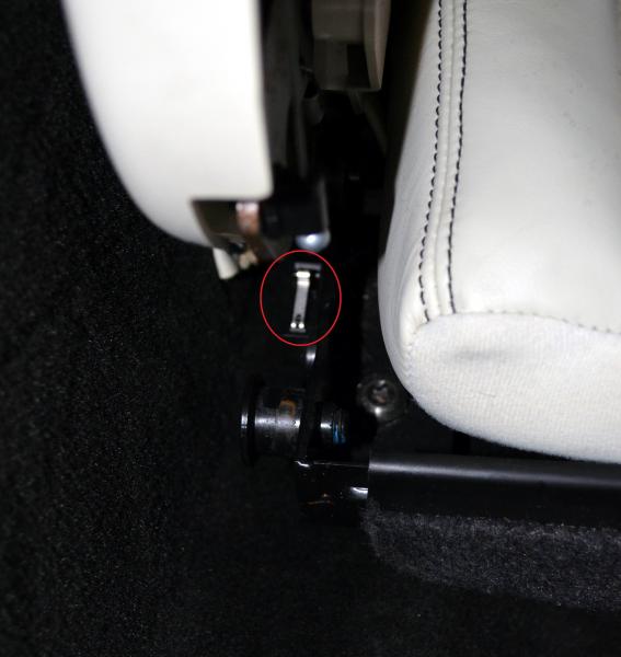

Old Oct 22, 2012 | 04:24 AM
Likes: 17,016
The poltergeist could be in the Seat Back Tilt/Headrest adjustor:
This is my driver's seat viewed from behind with the seat back tilted forwards. UK RHD so it's the opposite way round to yours.
The microswitch circled in red controls the headrest retract / reset. As the seat back is tilted for access to the rear seat, the headrest fully retracts. When the seat back is returned to the normal position, the headrest returns to its preset height.
This headrest movement can be triggered by pressing the microswitch blade. If you have a harness fault to the switch or it needs cleaning, this could be the cause.

Thanks for the additional information, Graham. If this situation reoccurs, I'll attempt to clean the microswitches and harnesses. Thus far, both headrests have stayed completely lowered since Saturday morning....

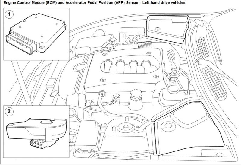

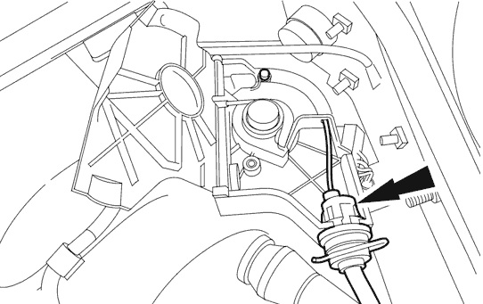

The throttle position is determined by the APP (Accelerator Pedal Position - item 2) sensor housed under the LH bulkhead cover:
The accelerator cable operates a cam in the APP sensor to send throttle position to the ECM (Engine Control Module).
This is why the throttle limits have to be reset after a battery disconnect to enable full throttle and kickdown to operate correctly.

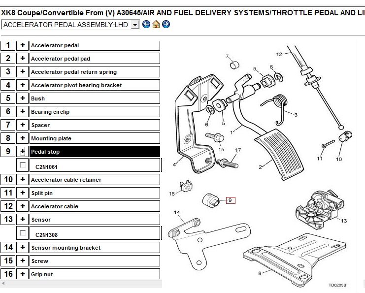

Here is the early throttle with the troublesome kickdown switch (item 12):
Many, myself included, have had to replace this part.
The Final Series XK8/XKR has a different throttle design:
The kickdown switch has been replaced with a pedal stop (item 9) and sensor (item 13) linked through the throttle cable (item 12) to the APP sensor in the bulkhead.
Although reports of failures on the early kickdown switch are frequent, I have not come across reports of issues with the later sensor or APP.
The comment from your local Jaguar Dealership suggests otherwise and I'm interested to hear which part of the Final Series throttle is failing at such an alarming rate.
