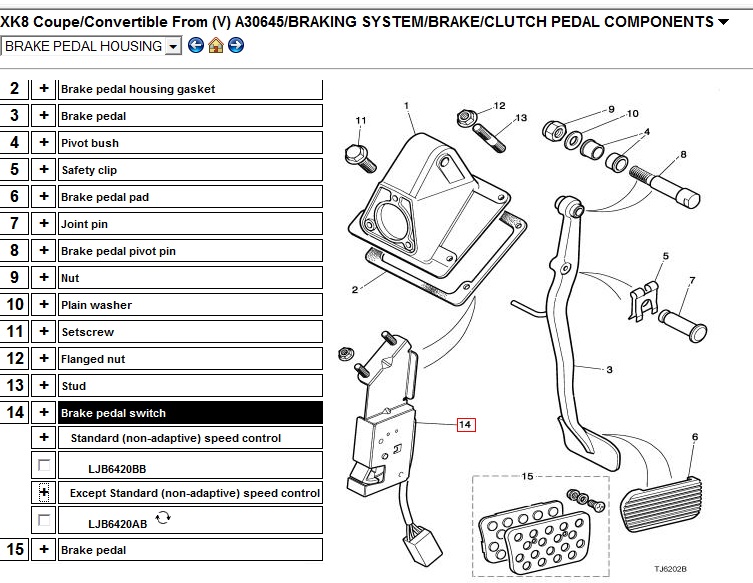

It's me that's losing the plot here!
BRAKE
It is this same switch that gives the cruise trouble right through the MY's. Item 14, the Brake Pedal Switch:

Based on your description I would be replacing the brake switch. I did replace the switch the recommended way but after I did it I found what I think is a simpler procedure and that is explained in the second to the last illustration. I hope this helps.
Link to switch replacement JagRepair.com - Jaguar Repair Information Resource
Link to the second option http://jagrepair.com/images/AutoRepa...8BrakeSw-5.jpg
Jon, that second link that Gus posted shows how to 'separate' the electrical component from the bracket, so you don't have to remove the switch from the firewall, just a part of it (from under the dash), making it a one-man job.
This is the original thread from 2010 where we all discovered the symptoms and diagnosed the brake pedal switch as the cause for both the 'cruise control not available' and more infrequent 'check rear brake lights' (or something like that) Remember the brake pedal switch is actually two microswitches in one part, that's why it can alone have multiple consequences of one, or both not working in the proper sequence (both closed, one open, both open, etc)

Many thanks to Matt, Gus, and Graham for your additional clarification here. I have a feeling that with my broad shoulders and huge hands, I'm facing a very difficult challenge trying to replace this switch myself. Correct me if I'm wrong, but I assume this job is performed by stuffing myself into the drivers side floorboard and attempting to reach up underneath the dash to get to the switch, yes or no?
Also, once the new switch is installed and the ignition is started, do the "Cruise not available" and "Check rear lights" messages disappear from the dash with no further action required? Or do I have to reset the system somehow?

. Easiest with seat removed, however. All messages will clear like magic when replaced, no reset or manual clearing required.
