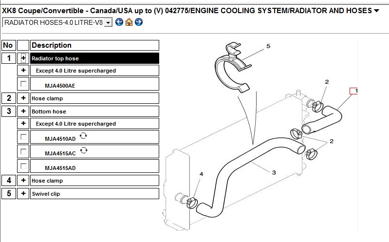

The temperature gauge on the XK8/XKR is not reliable. The engine will overheat long before the gauge moves. Follow the link in WhiteXKR's post #4 above for the full story and his ingenious fix for the problem.
Is it only the Top and Bottom Radiator hoses that you're concerned about:
These are widely available but there are several more in the cooling system only available from the dealer.

I believe it is only the upper/lower hoses but I wont be under the car until tomorrow. And I will follow the link.
