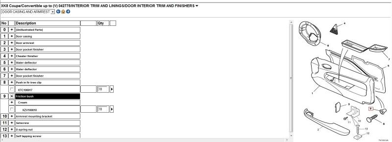

Is it Item 9 (Friction Bush) you need?
There's nine on each door and they were supplied in packs of five the last time I needed replacements.
Attached Thumbnails '99 xk8 conv door panel connectors, and combo turn light switch-door.jpg

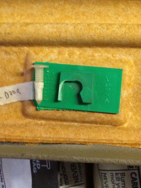

I think so lastic friction plastic pin on backside of door panel AND the connector that is glued to the back fo panel and holds the pin to the panel.Thanks

Default Pictures of door panel connectors I'm seeking'99xk8
[attach][attach][att'99 xk8 conv door panel connectors, and combo turn light switch-302.jpg
'99 xk8 conv door panel connectors, and combo turn light switch-307.jpgach]24980[/attach][/at[attach]24979[/

I'd go to a dealer and see if they are available separately from the door panel and then get the part numbers.

I need a couple of these for both my XKR and my X-Type but I don't think you can buy them separate from the door panel. If you find a source, please post it here. Thanks,

The parts are not in the published parts diagram. A dealer might have more information.
If they are not available, if you have the broken bits, the clips can be repaired quite effectively ( I have done it) with JB Weld (regular, not Quick set). Even if the bits are missing, you probably can cobble a repair together with JB Weld and some scrap plastic.
If you really want the originals, then get a used door panel from a breaker or ebay. The clips are attached with hot melt adhesive, so some judiciously applied heat will remove them.
