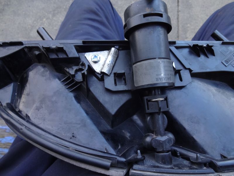

You will need to separate the washer jet mechanism from the lamp unit first before it will come out, you need child sized hands to do this. It is held in place with two tabs the need to be depressed.

This is what it looks like from beneath after I repaired mine.

I had to do this a week ago: the lights tend to jam on the jet wash down pipe and/or the bracket that holds the bottom bolt. The trick is to remove the jet wash unit by pulling it towards you just as the light unit is nearly out. You should then be able to jiggle the unit out.
