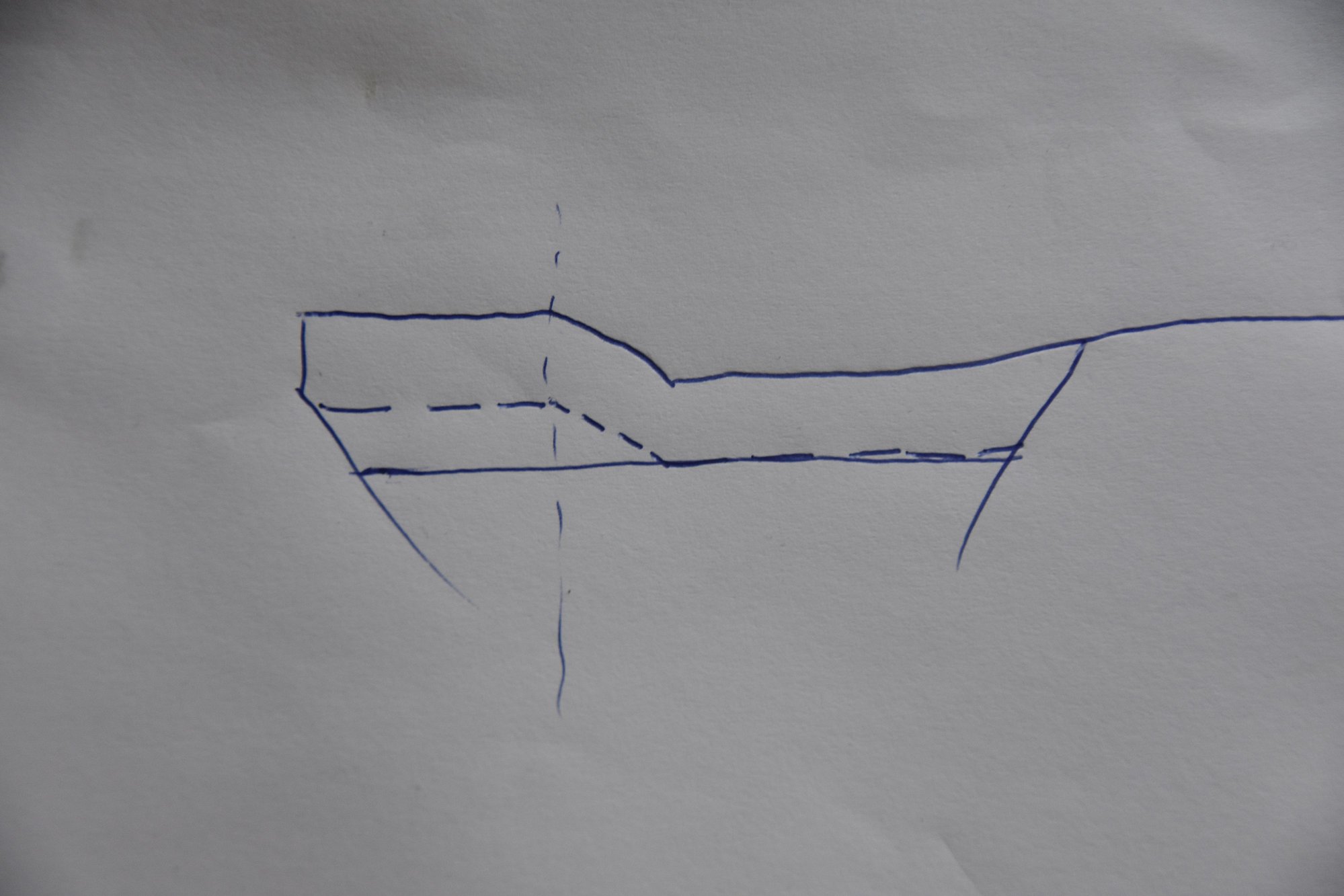

Excellent ..top marks for that. ( note US lamps have a vertical cut off not angled )
I guess you are saying to cut it like my drawing ...dotted line but keep the start of the downward kink central to the lens. Yours is RHD so in UK so the high bit would be the other side.
I dont know how bodged in my LED units are or how simple to remove ( very big fans on the back) and its getting cold now to work but this looks great.
Dotted New . Vertical dotted centre line of lens

Yes, that drawing is pretty much where I cut, so that the highest level is now what was the lowest level before. My first attempt gave me exactly what I wanted, but I'm sure there is plenty of room for experimentation.
