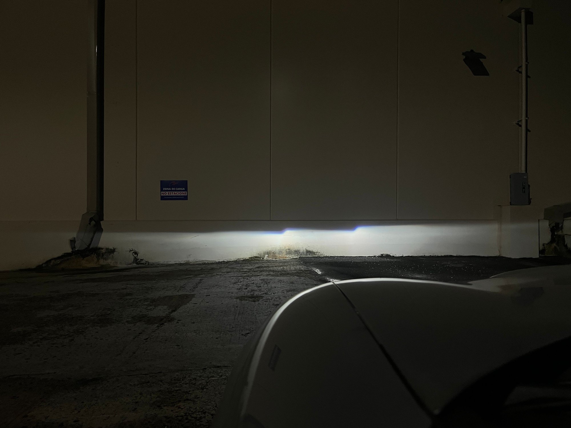

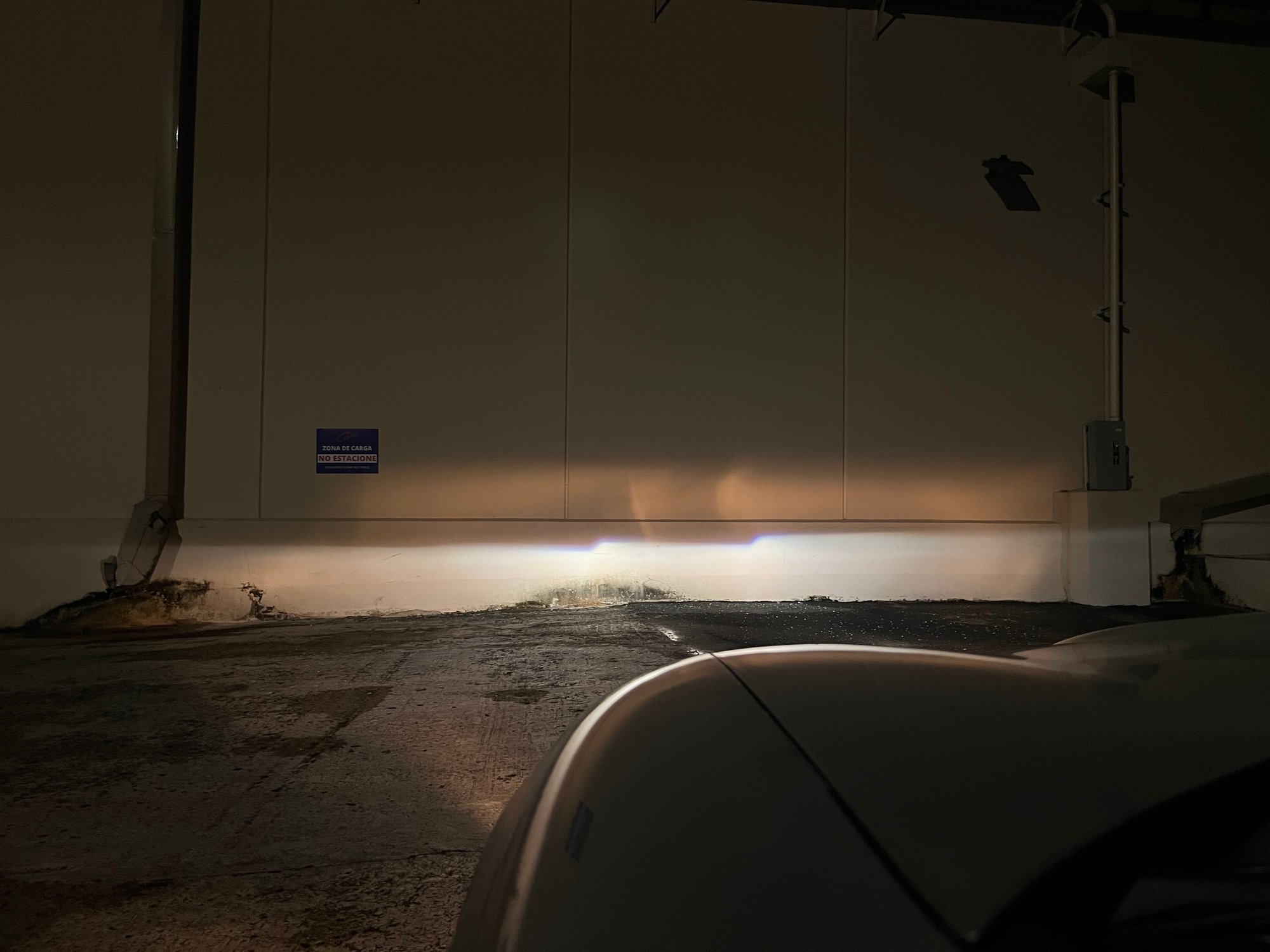

Just wanted to post these images I took today to show you what is possible if you ever decide to retrofit upgraded projectors.I should have also taken pictures while driving, but I did not have a passenger with me.
The Micro D2S 5.0 bixenon projector I mentioned in a previous post in this thread should out-perform the 4TL-R, but as you can see, the light output is already very good. I can see everything at night.
I think my right fog may need to be aimed, but those are the OE fogs and bulbs. I am considering which route to take to upgrade them.
Bixenon Morimoto 4TL-R in low beam mode.
Low beam + OE fogs
Bixenon Morimoto 4TL-R in High beam mode + Morimoto Mini HB High Beam projector
OE fogs only
