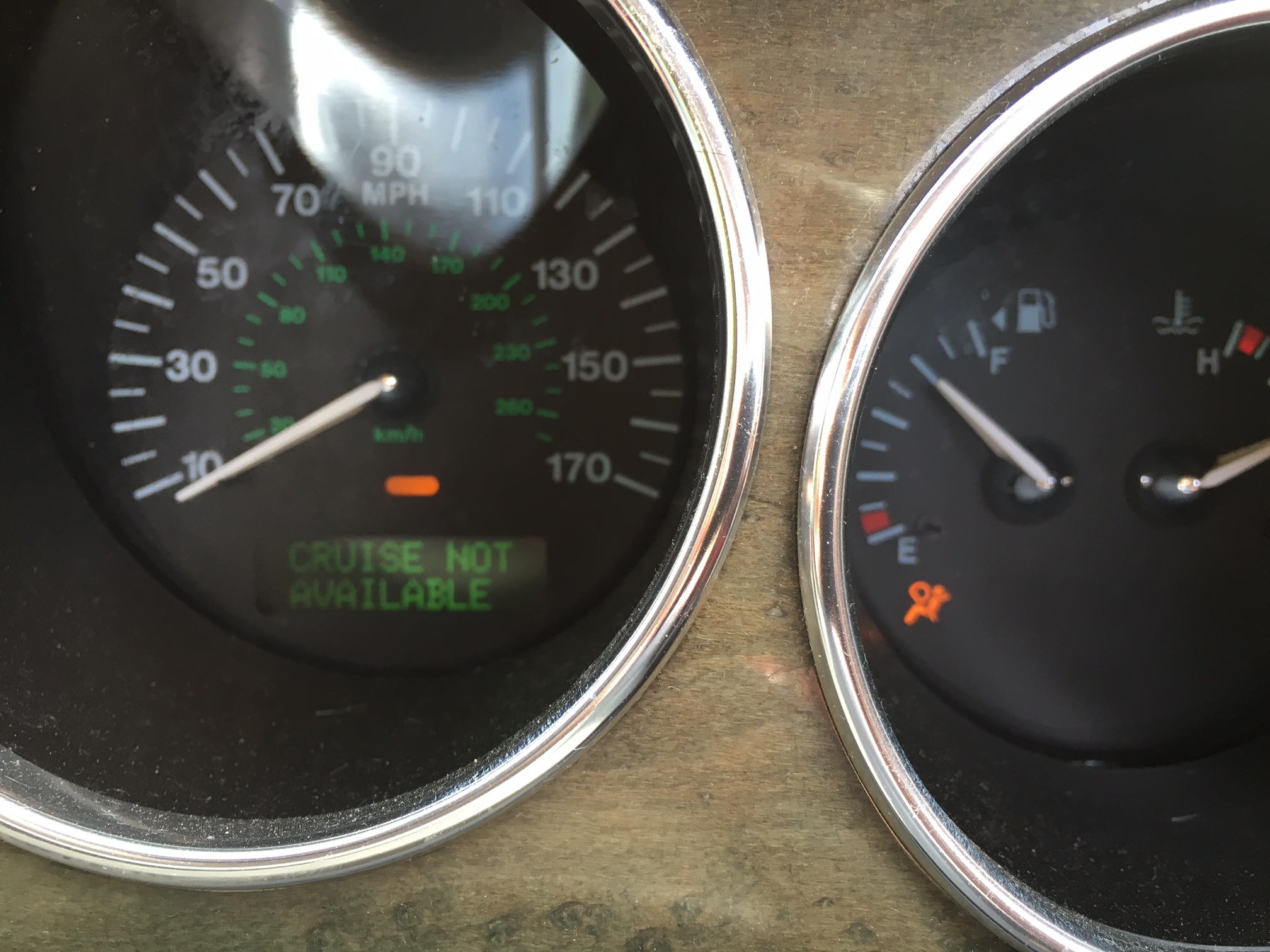

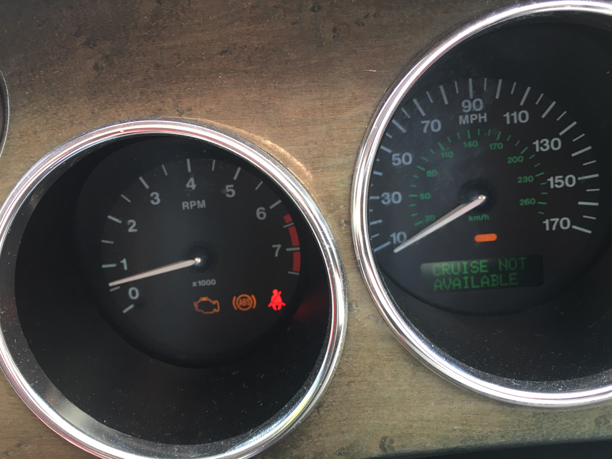

Hi,
My friend is selling his XK8 he has had it for 11 years. Originally serviced by main dealers now by a local man who does not have diagnostic tools to turn off the lights on the dash. It has had a new gearbox, disks and pads recently and serviced regularly. Engine runs fine, no rattles or smoke goes ok but ABS is not working.
These are the lights on the dash, is it too scary to take on?
I am fairly confident with spanners etc.
Body work is tatty but would look ok if given to the right body shop for a light polis and touch up. Trim is ok, black and red not seen another at the moment. 2002 4.2 Coupe.
All help appreciated.

You need the codes DC. Many repair shops or auto parts stores will loan or rent you one. Post the codes and the experts here can give you a better idea what you are facing.
It could be as simple as dirty wheel sensors or something much more serious. Also I would be suspect of a mechanic who doesn't have one. They are pretty cheap these days.

Check out the YouTube link on how to clean the abs sensors
real easy to door cleared my abs fault but be careful not to snap one as they are a pain to get out its best to take the wheel off rather than turn the steering lock
