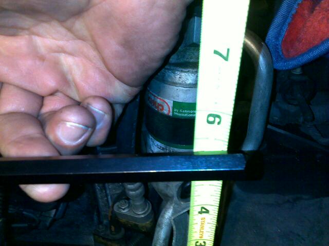

I have 98 XK8 with a rattle from the passenger side at start up with a little bit of acceleration.... so we pulled cam cover and found we had new primary and secondary tensioners... we have 26mm of slop between the top of the tensioner and chain... the lower part of the tensioner seems tight...
Is this do the VVT ( variale valve timing ) ?
Old Apr 28, 2012 | 11:35 AM
Windycityx's Avatar
Posts: 312
Likes: 10
From: Chicago suburbs
A little more information. If I put an allen key (hex key) in end of valve cam and rock it back and forth I can increase the slop in the chain and actually see the lower side of the tensioner colapsing without much force required. Do the tentioners have a built in check valve system to keep them from collapsing? I can see aqt least a 1/4 of an inch expansion and copllapsing of the bottom side of the tensioner?
Is this normal?

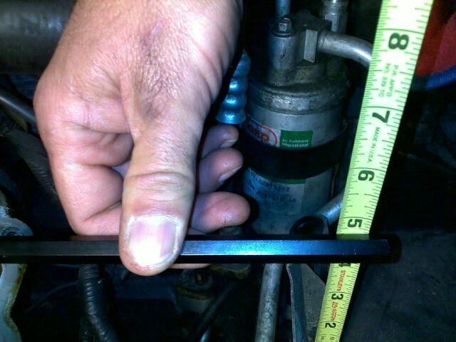

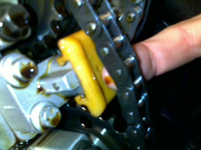

A few observations... as you can see in the pictures we advance or retard the exhaust cam with a hex key.. you can see that I can put a pinky finger under the change, and for a reference point you can see on the tape measure the gap between the tensioner

Only one side of the tensioner puts tension on the chain, so that is OK.
The other side should provide considerable resistance to collapsing, so that is concerning.
I am suspicious that the new tensioners were installed without replacing the bolts. The new bolts are slightly shorter. If the old bolts were used, you will get an inadequate seal between the tensioner and the head.
In a pinch, you can grind a couple of mm off of the end of the old bolts and reuse them if this is the problem. You will not be able to tell if this fixes the problem until you replace the valve covers and run the engine to repressurize the tensioners.

I went down to Toms to help him change the tensioners (My hand in the pictures) and noticed there is very little tension required to collapse the tensioner and thought it was very odd. If I had to guess I would say that the Exhaust cam is easily movable between 5-8 maybe even 10 degrees with the hex key in the exhaust cam by rotating the exhaust cam. Seems very excessive to me.
IS there any type of check valve in the tensioners to maintain pressure once the tensioners have been filled with oil ?
Barry

From memory i think the top tensioners are handed. if you have them fitted on the wrong side, the oil ways won't be lined up, so they won't pressure up.
Old Apr 28, 2012 | 03:53 PM
Paul Pavlik's Avatar
Joined: Aug 2009
Posts: 1,205
Likes: 434
From: Milwaukee, WI
The pic shows that the correct Tensioner is mounted on the Right Side. The Fixed Shoe faces Up and the Movable Shoe faces Down. Opposite for Left Side.
