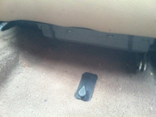

So my new to me XK8 has an electrically dead driver's seat, as well as no heated seat on the driver side. I've done some searching and it appears that the drivers seat modules corrode and fail, and also possibly break traces inside and need resoldering.
Now here's the dillema. My seat will NOT move. It's all the way back (touching rear seat) which is ok as far as driving, but wont let me access the bolts to pull it out.
I tried looking under the seat, and cant see any bolts, although I do see some zip ties around what I believe to be the module.
Anyone who can help with a way to get this thing out?
I'll attach a pic of what I mean.

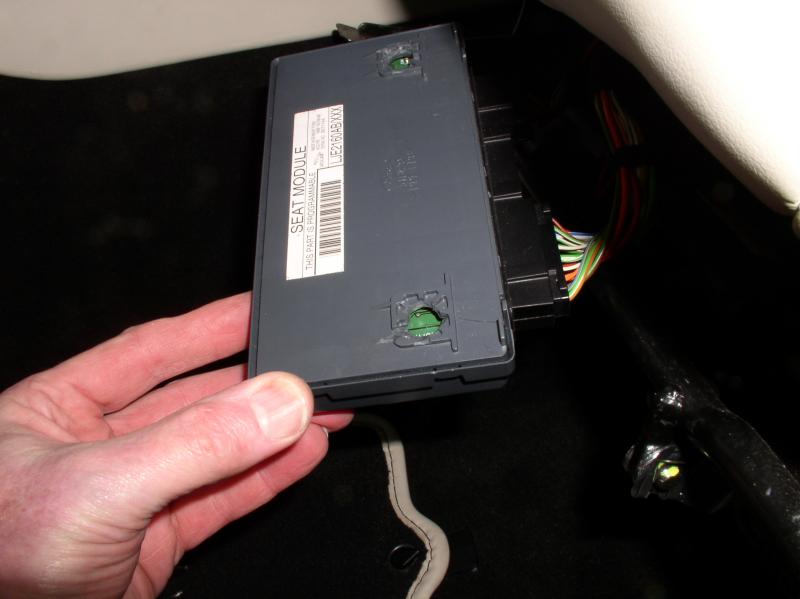

Someone has been there before you. The module should be bolted to a bracket which in turn bolts to the underside of the seat. It's common to find the module cover broken and this kind of zip tie fix applied:

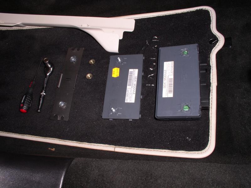

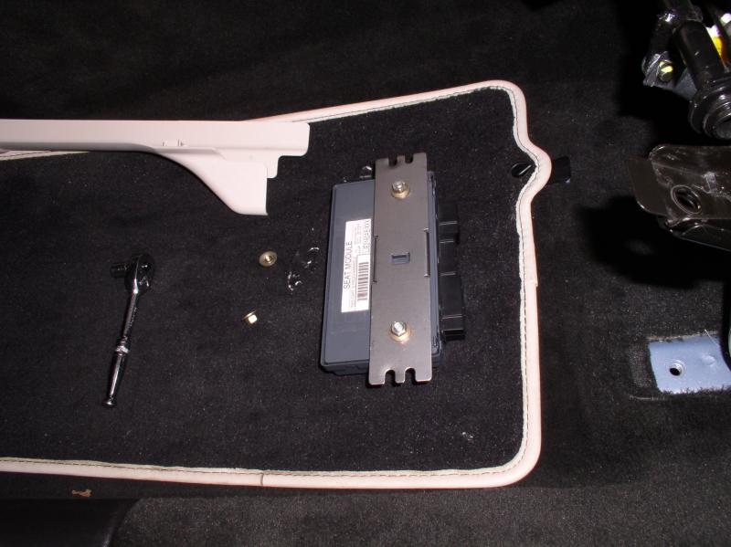

Mine was the same so I obtained a replacement module cover:
Help removing drivers seat module-13-passenger-seat-module-bracket-fitted.jpg
One solution to be able to move the driver' seat is to cut the zip ties, release the two modules connectors and swap it for the working module from the passenger seat. You can then move the driver's seat to access the four fixings, remove the seat, repair the module and re-attach it securely before refitting the seat.

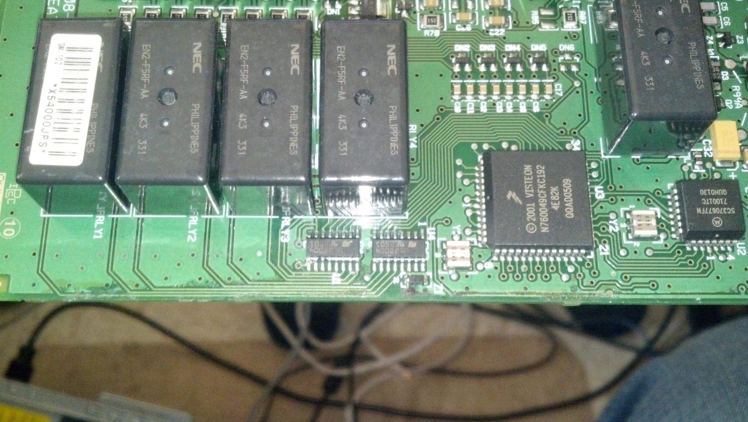

So as Graham suggested, someone had been there before. This is what the module looked like when I pulled it out.

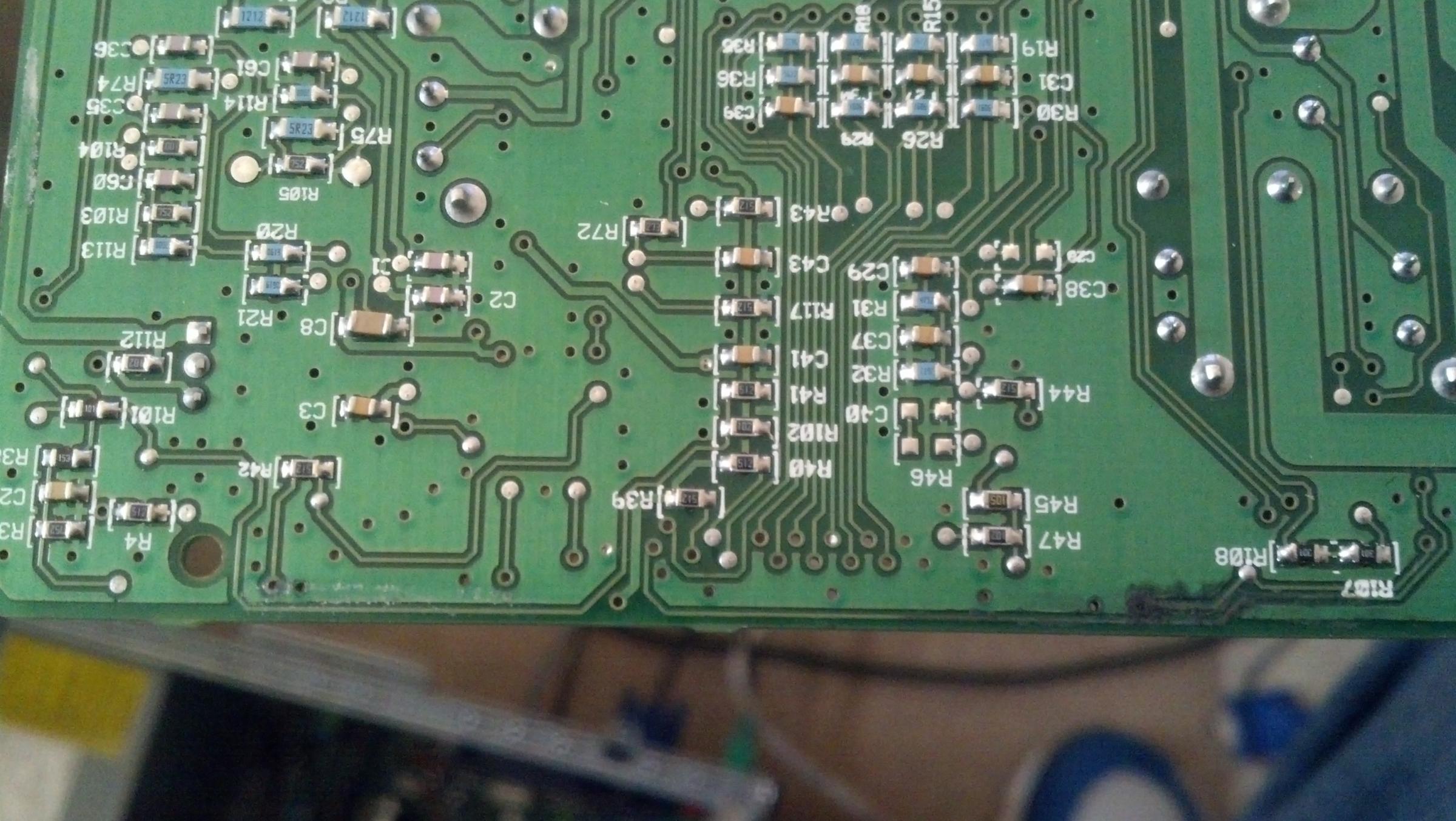

So after I got the cover off, I pulled the board out, and took a look around. I found two broken traces in the board, - interestingly there was one on each side of the board. Probably from it having bounced around the case.
I used some jumpers - and fortunately jaguar had holes in the board with pads to solder the jumpers to.
Look at the bottom center of this pic. You can see the subtle break in the lower most trace. Sorry my iphone doesn't take the greatest pics.. especially up close
Here was the broken trace (once again along the top edge) of the board on the other side.
These pics were before I soldered. I soldered on the opposite side of the respective trace. I plugged the module in prior to soldering and everything worked, all seat functions, AND the driver heated seat now turned on! Success!!!!

Hey, I'm prob a bit over an hour or so north of you if you need help with the boards. The breaks aren't obvious - look at the pic with the large chip. They kind of look like dark spots in the trace. I'd be glad to fix them for you if you want to drive them up or send them up.

See the photo in post number 5 above. Add wires at the endpints of the traces along the edge of the board.
Cleaning the traces with some alcohol and using a magnifying glass will help you see the break or breaks along the edge of the board. This is an easily repairable fault. Bring it to a local electronics repair guy if you do not want to do it yourself.
