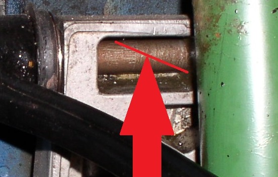

Old Dec 7, 2017 | 04:18 AM
I've had loads of trouble with these over the years and almost always ended up needing a new fulcrum bolt.
I have a theory that an oblique cut across the fulcrum bolt will greatly reduce the torque necessary to free each end as they can then be rotated independently after the usual application of release oil and heat:
Help - Upper Wishbone bolt stuck-wishbone.jpg Help - Upper Wishbone bolt stuck-wishbone-2.jpg
The shock absorber would have to be removed and the wishbone pivoted upwards to give access but it could save a lot of time.
