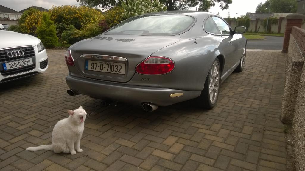

The deed is done, and this is easily the most useful mod I have done to this car. The best thing about it is that it's almost invisible when not in use.
Quite easy to install too - four holes need drilled into a section beneath the bumper, and the bumper does not need to come off. 90 mins is all it took, and another 60 mins for the wiring and testing.
Thanks to wUnderCarParts - We put U back in cUstomer Service - Homepage and their Ebay portal for coming though. They were a pleasure to deal with. Bad karma to TrendsAuto and HitchAnything for taking money and then telling lies, forcing credit-card-company intervention.
