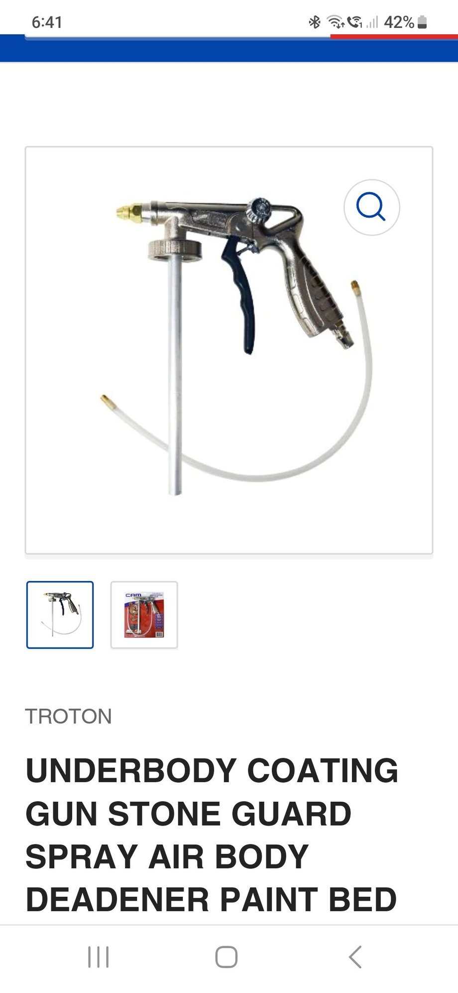

The closest finish to the XK8 original that I've used on an old Sprite was Stoneguard. It's put on with an air supplied gun like the one below. I bought water based stoneguard from a commercial auto paint supplier rather than the DIY auto store. I then sprayed with primer, base coat and finished with clear. It's not a quick fix but will last well.

Yes I got that gun for my Waxoil

That's perfect! You should be able to get the stoneguard that will take that gun. I experimented on some cardboard to get the best finish. The product spatters onto the surface and the air pressure setting determines coverage, bump size and smoothness.

In fact I fit a 1 litre plastic milk bottle to it to spray waxoil se my post "how to spray underseal"
