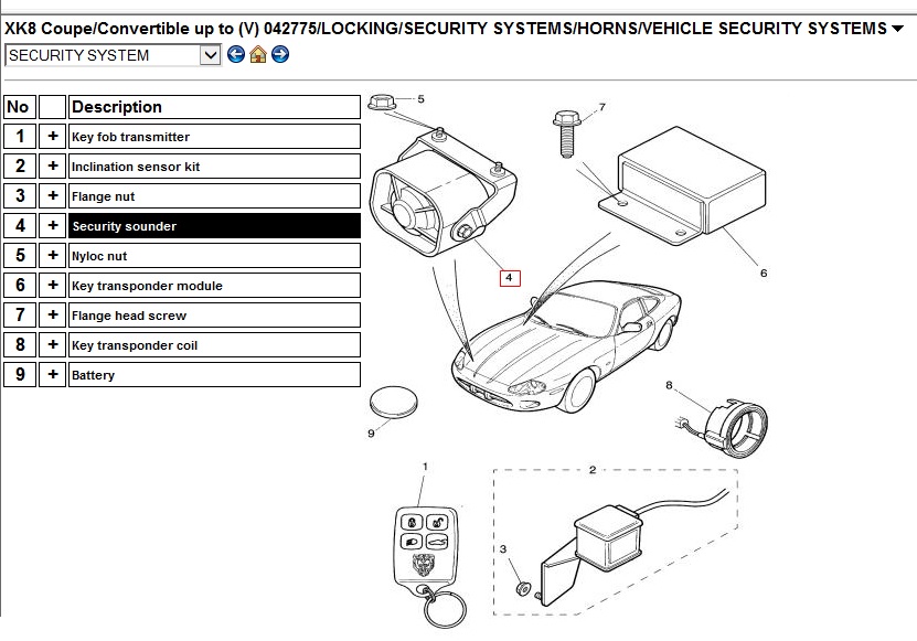

I thought the Security System had an independent Sounder (horn) (see item 4):
Information on the Security System isn't available in JTIS but it seems logical the alarm Sounder can't be silenced simply by pulling a fuse.

I thought so too, so I was somewhat surprised to find out the alarm used the "normal" horns. Btw, this is a US spec car.

When the anti-theft alarm is triggered the system flashes the turn signal lamps, and sounds the horns, anti-theft
alarm siren or a combination of both (Market dependant).
The one you have indicated Graham, is the anti theft siren. The above statement is from my manual.
