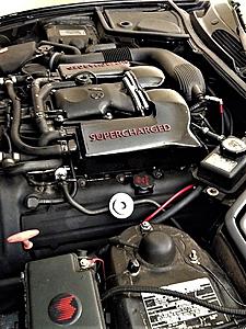

OK! You bought a 2002 Jaguar XK that you think is an "R" but your not sure and you think it has a 4.2 Engine but you don't know if it's Supercharged or not! Is that about it? Oh! and It gets HOT!!!
The first thing I would do, with the information provided is call a Wrecker and Haul the Car to the closest Jaguar Dealer or Jag Specialist and find out what you have and what's wrong with it...Why is it getting HOT? Do this before you ruin the Engine, if you haven't already!
I've always thought the 4.2 came out in the 2003 Model? You said your Jag was a 2002.......I could be wrong here since you are in Scotland...I'm not 100% sure but I think you have the 4.0 Engine.......Then you say you think it is Supercharged but your not sure.......Norfskate, have you thought about raising the Hood/Bonnet and looking? Do you know what a Supercharged 4.2 Engine looks like? (see below) Also you might want to check the Coolant......! You know where to do that ; don't you?

Woooah bcprice36, slow down, I think you may have miss read my original post. It is an R, it is 2002, and it is supercharged, I have zero doubts there!

Lastly, yes, I know what the SC looks like, yes it’s there under my bonnet, and yes all engine fluids are topped up perfectly.
