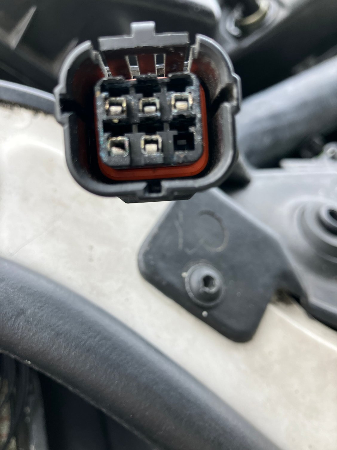

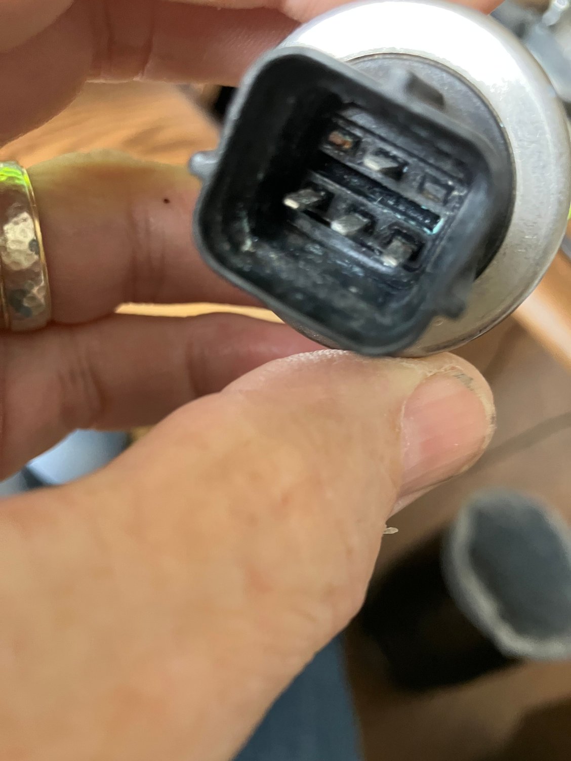

so I pulled the connector. and there is a lot of corrosion in the plug
where does that come from? is this the source of my refrigerant leak? all
refrigerant leaked out over 2 days

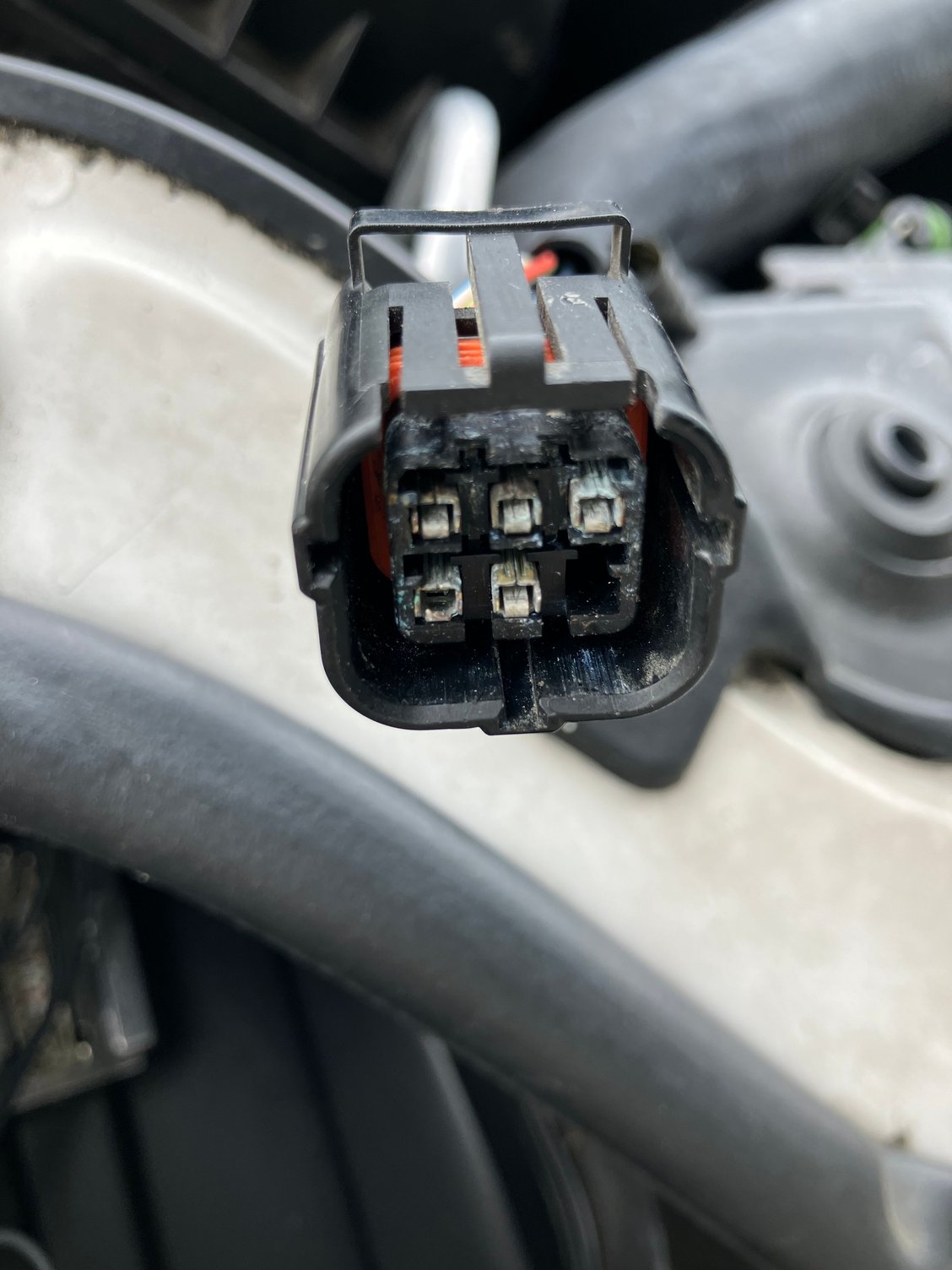

the corrosion eroded one tab completely

so I took apart the connector. and I will replace the contacts
