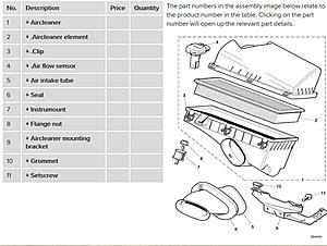

I have attached a parts blow up of the air cleaner. If it can get plugged up, I don't think so. I have never heard of that happening.

We can't find the outermost part of the scoop itself. Fender mud guard flap entirely conceals that chamber or whatever that is behind headlight assembly. But thank you for image confirming there is no labyrinthine routing of additional stuff.

It is straight into the void. It is visible with the underside tray removed. The location is so that it is a cold air intake but available to direct wet weather.
