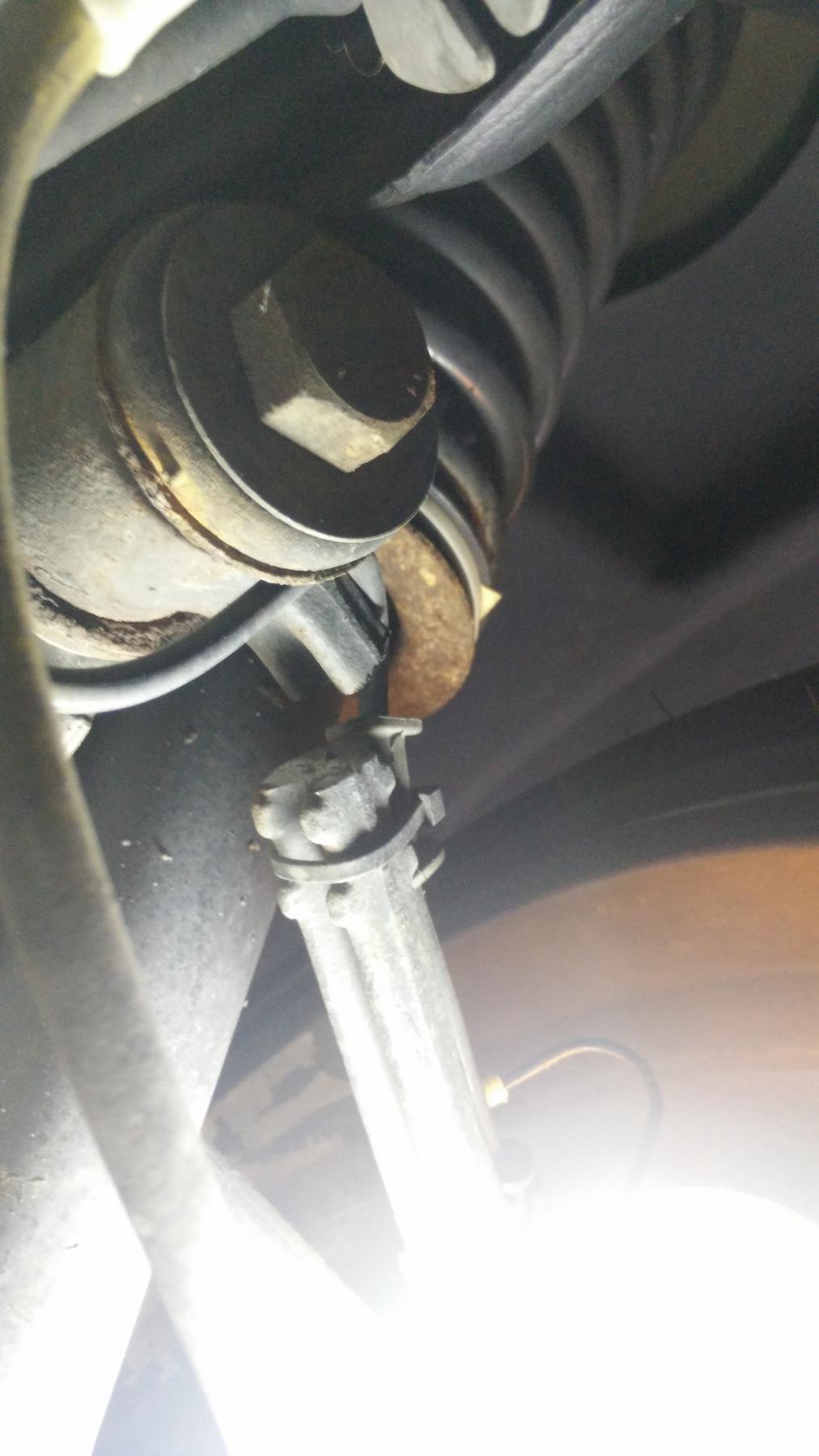

Front end was thinking badly, crawled under and found this
Broke clear in half!
What part is it?
And what am I in for?
Ugh!

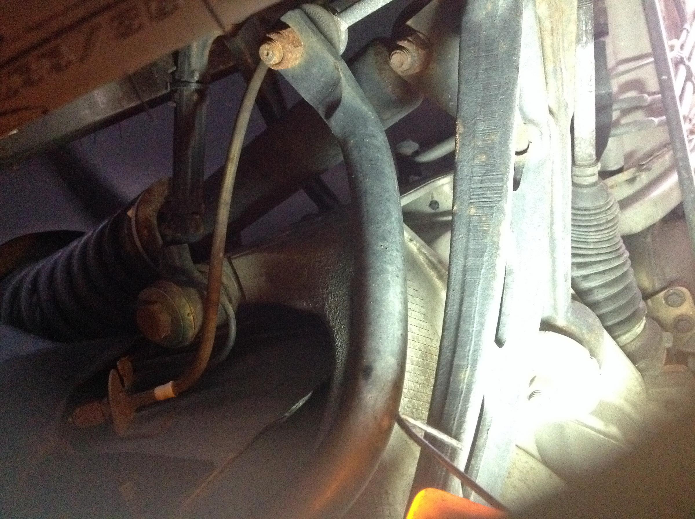

Looks like the control arm?
Correct name?
Looks straight forward, but I know nothing is as it looks

Ouch! Looks like a broken upper wishbone.

It's hard to tell from your photo, but if it is the upper wishbone, you should be able to get a used one from "Coventry West". Shouldn't be that expensive, but if it seems so, shop around. Once you get one, changing it out should be no more then some "video's show you how" even the "how to replace your upper control arm bushings" will do it.

Yes according to Dave's chart, that's the one
Is that Xk/XKR specific does anyone know, or is it the same as other models
Thanks, looks like new is about $500
I'm going to start hunting down used prices...
Fingers crossed!
Hope that bolt comes out easy (you know it won't)

Check ebay, a quick search shows several for under $100, while your are at it new bushings would be in order as well as a new ball joint. As rusted looking as your parts look I'd say you are in for a lot of problems. Can't think of what would have caused this to break.
