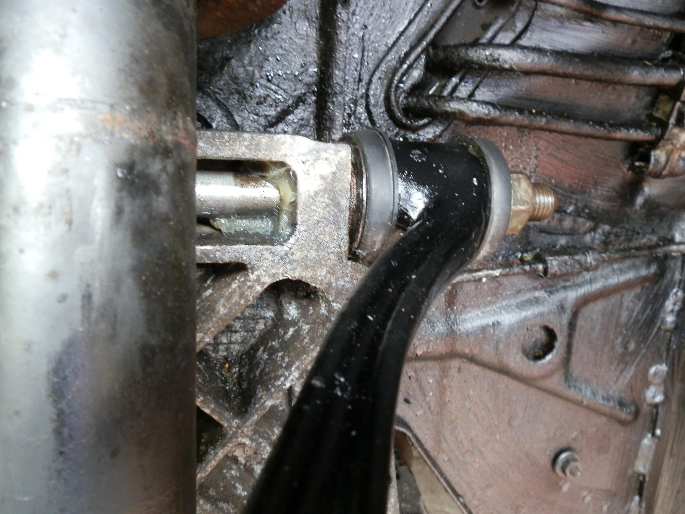

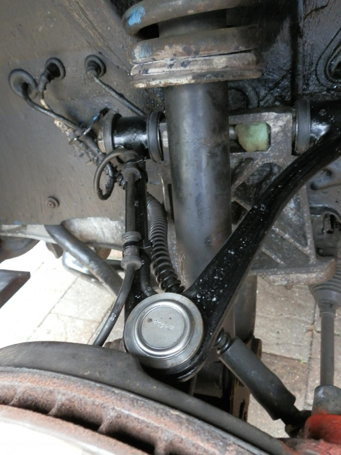

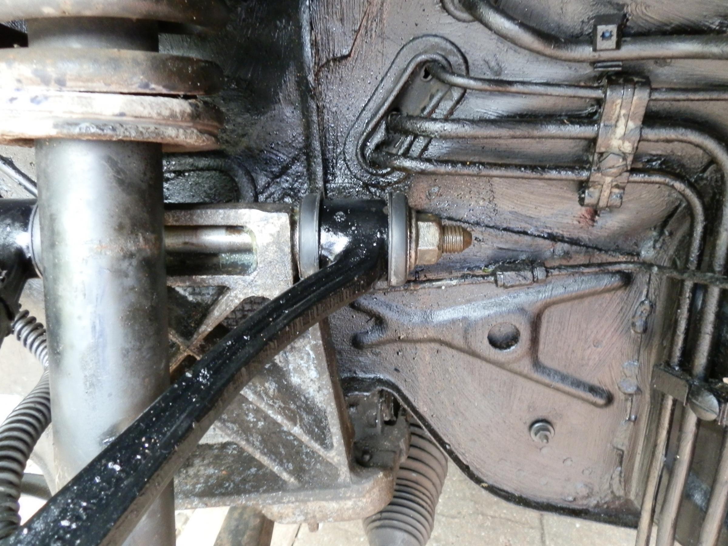

Talking The finished job.
Just a few pics to show the completed job.
Nice.....
Attached Thumbnails How much is this gonna cost me?-p9170578.jpg   How much is this gonna cost me?-p9170580.jpg   How much is this gonna cost me?-p9170577.jpg
Nice.....
Congrats, I just want mine back.....
