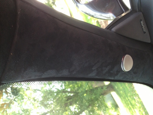

That price sounds quite exorbitant. The a pillars are the easiest pieces to do. The simply pull off and except for a small star bit to remove airbag sensor, it would only take some spray glue to install. Very easy! Door panels are a bit moe fidgety to remove but once removed, the center panel easily comes out.
I'd checkout a few custom trim shops for pricing. It really shouldn't be more than 4-500 to do these upgrades even with top grain leather.
I did my conv a pillars and small headliner above the window myself with alcantara suede used in Porsche and such, doing the door inserts as well but having the seat inserts done at trim shop. Only 250.00 in labor, using existing leather seat skins and me supplying the alcantara..
