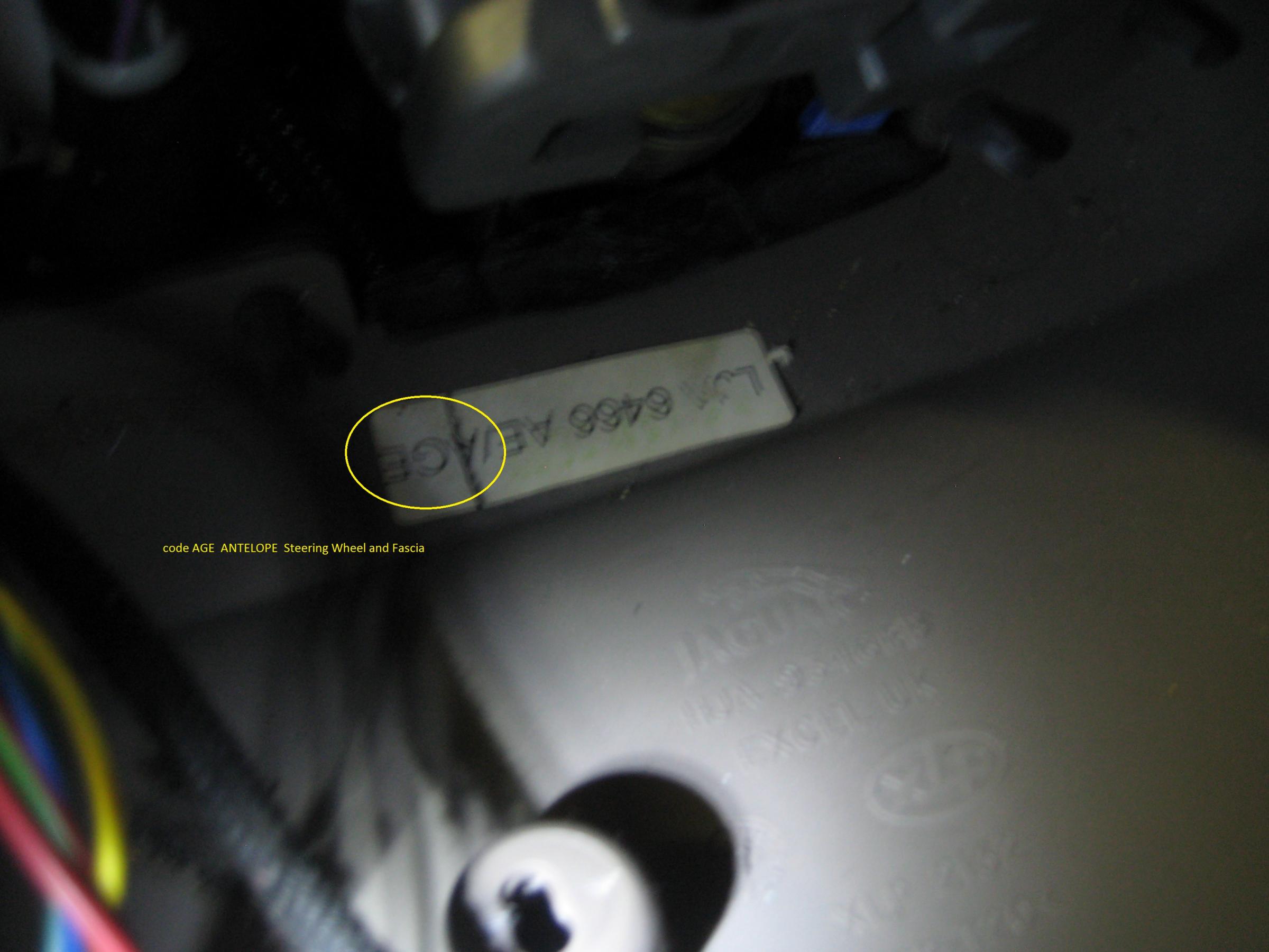

I found my steering color code by removing the underside of my turn signal/wiper lever housing. (My trim is quartz / oatmeal while the steering wheel is code AGE Antelope which is quite common)
Here is a link to the type paint that I used:
JAGUAR ANTELOPE (AGE) Leather Repair Pigment Dyes With Unique Applicator Sponge | eBay
Attached is a pic of the housing color code.
Also when I removed the airbag, the color code inside it showed "AGE".
Attached Thumbnails How to "restore" the steering wheel assembly ?-steering-wheel-code.jpg

It is eiher Antelope (AGE) or Sable (AEK). Hopefully you will see the label when you remove it.

I'm thinking this is a typo. Antelope is (AGE) and Oatmeal is (AGD). Agree?

Yes, it was a typo...thanks for pointing it out. I corrected it.
