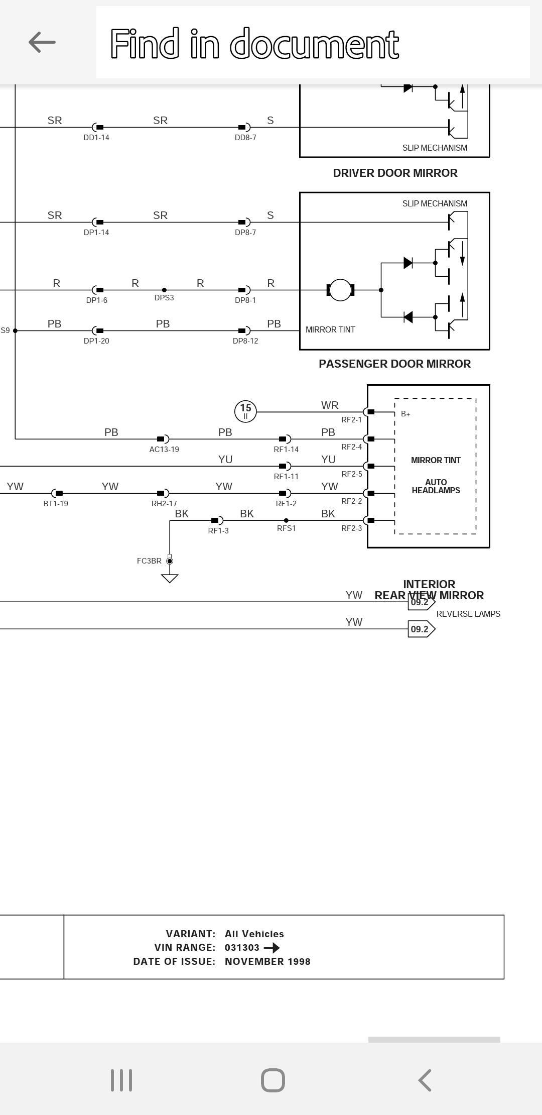

Here's the 1999 diagram. I wonder if the 6th wire (quick scan i only see 5 here) is rain sensor?
FWIW don't forget that reverse gear turns mirror dimming off. If you need to know which wire is grounded to turn auto head lights on ask. I posted it before, can probably find it faster than you.

Battery white red
Tint purple black
Auto headlight yellow blue
Reverse yellow white
Ground black pink (transmission tunnel rt side)
BTW do you realize these are the colors from the car not your mirror?
