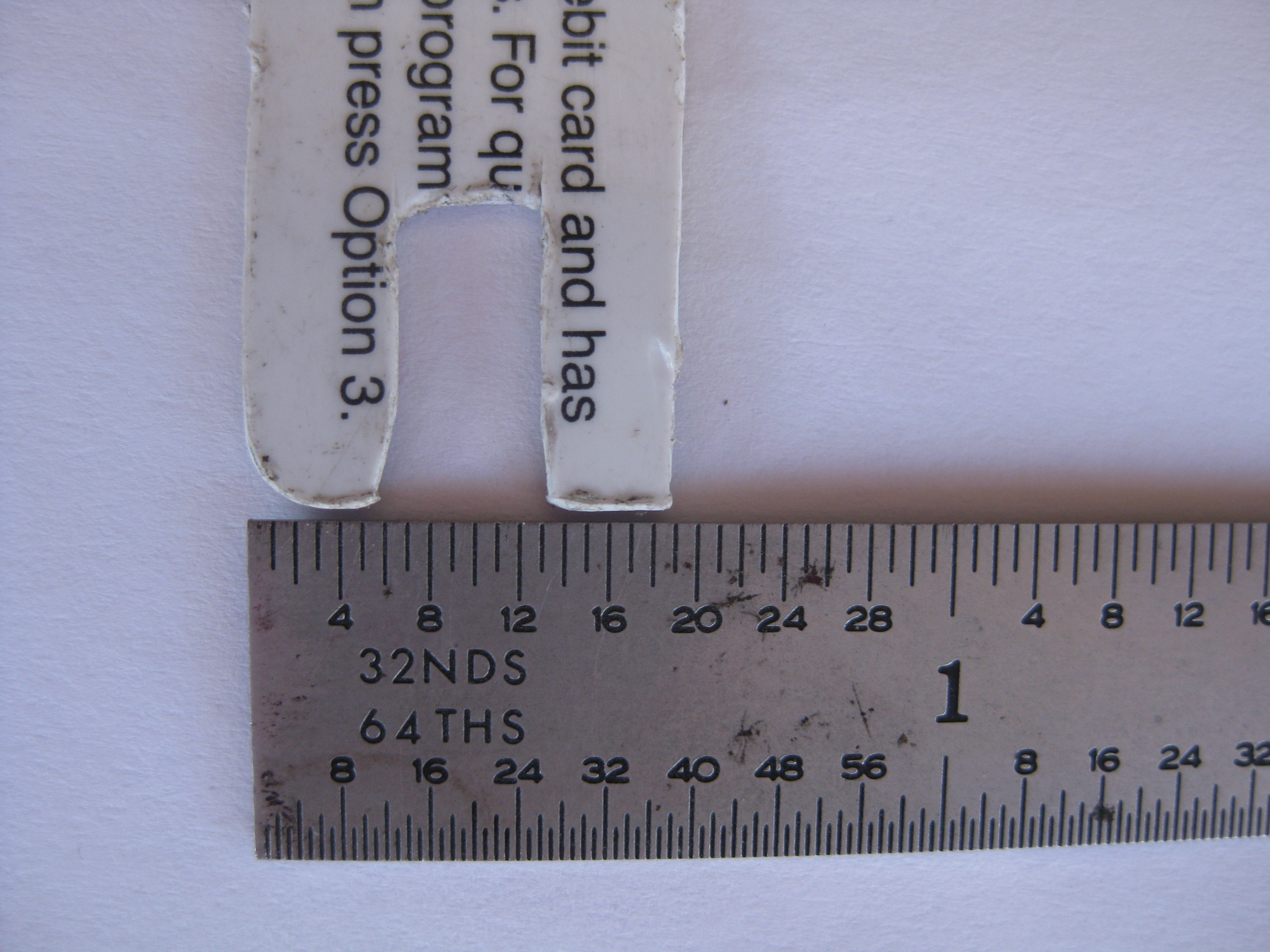

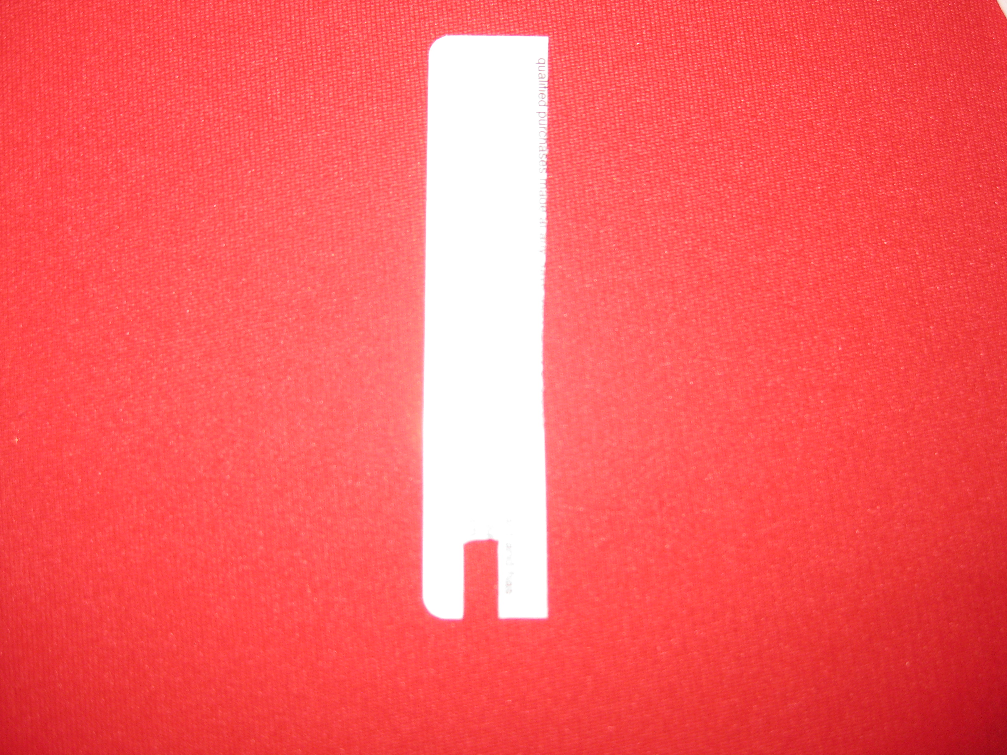

but you can make a plastic tool that works pretty well.
Attached Thumbnails I Give Up- Anyone know the trick gear selector surrond removal?-img_4594.jpg   I Give Up- Anyone know the trick gear selector surrond removal?-img_4595.jpg   I Give Up- Anyone know the trick gear selector surrond removal?-img_4582.jpg

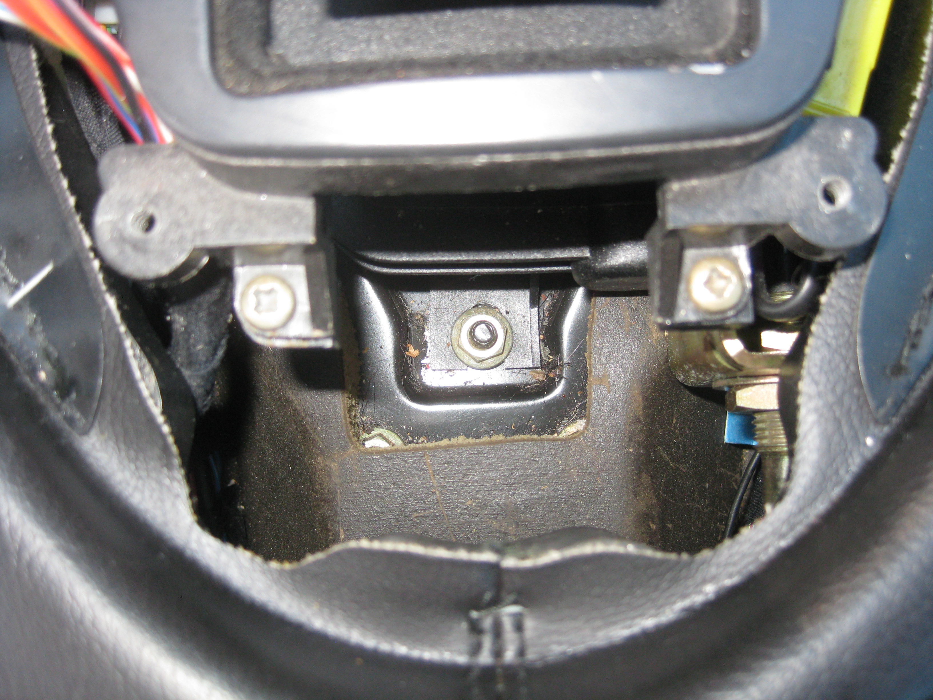

here are the clips to release and the nubs
Attached Thumbnails I Give Up- Anyone know the trick gear selector surrond removal?-img_4576.jpg   I Give Up- Anyone know the trick gear selector surrond removal?-img_4577.jpg   I Give Up- Anyone know the trick gear selector surrond removal?-img_4578.jpg   I Give Up- Anyone know the trick gear selector surrond removal?-img_4581.jpg

here is what it looks like removed
Attached Thumbnails I Give Up- Anyone know the trick gear selector surrond removal?-img_4584.jpg   I Give Up- Anyone know the trick gear selector surrond removal?-img_4588.jpg   I Give Up- Anyone know the trick gear selector surrond removal?-img_4591.jpg
