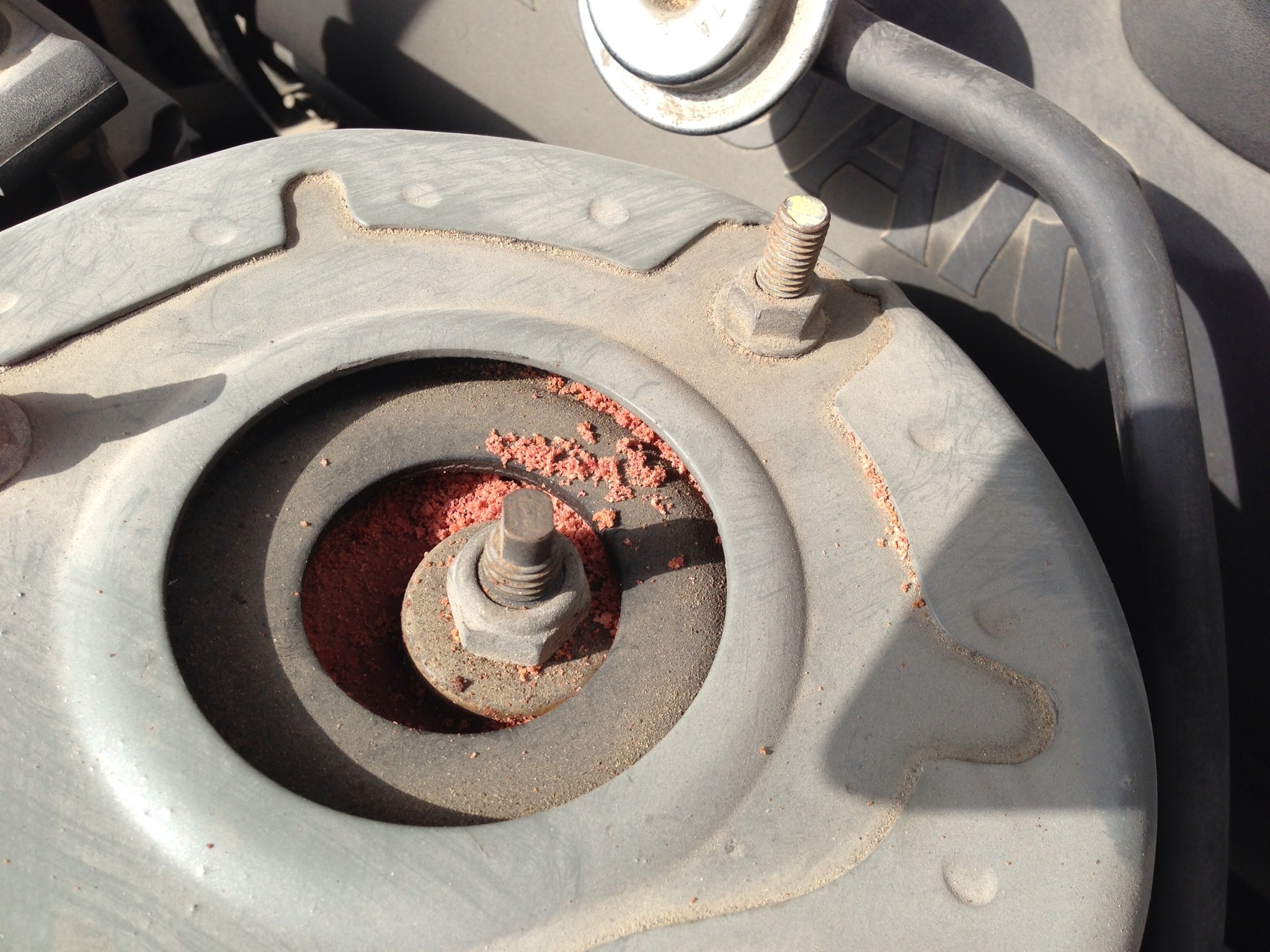

Advice too please, I've got a severe 'clunk' too (suspect the top mounts) so I'm just about to order 2 new front shock absorber mounts for my 2005 XK8...
While I'm having these fitted, is there anything else I need to consider replacing on the suspension / bushings at the same time?
Cheers.....
Old Sep 4, 2013 | 08:11 AM
  #33
azeteg's Avatar
Joined: May 2012
Posts: 289
Likes: 51
From: Liechtenstein
Cheers.....
Dude, that mount is seriously shot. Look at how off-center the shock is!
You don't mention if you have CATS or not, but if you don't, it would be a good idea to replace the front shocks as well, since they also include new bushings, and are only around 100 USD each. Cheaper than the top mounts!
Also check out the state of your other bushings, especially the sway bar bushings. Also check the sway bar links.

Thanks Azeteg.... Good advice, I've ordered the XK8KIT1 XK8 SUSPENSION KIT to replace all the bushings, however I'm just checking the the kit includes the Shock Absorber Mount #MJA2170BD as I don't see it in the kit.....
Any other advice would be much appreciated azeteg.... Cheers
