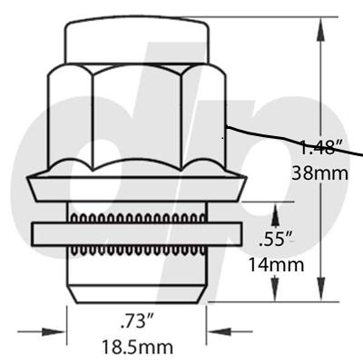

When I put my Coventry wheels on, I had to get all (20) new wheel nuts. I got them from Adamesh. They are flat.

What I thought was a manufacturer stamp was actually left over sticky stuff from weights that have fallen off. I'll have to take one off and see if there are markings on the back of the spokes.
Thanks for posting a pic of the flat washer, they are similiar to what is on my BMW, so while I have a wheel off, hopefully I can also determine if they are flat inside.
