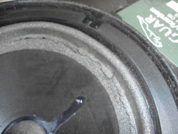

Due to circumstances beyond my control, the car had to sit outside during our extremely wet Autumn / Winter, and this, plus 16 years or so of use, resulted in falling-to-bits drivers :-

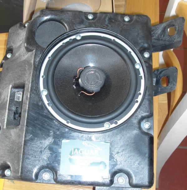

which I reckoned would be pretty much "plug 'n play". And, as it turned out, they are. They have several mounting holes around the side and four of them line up with the existing cabinet locations. They just drop in - the HK cabinet already has a rubber gasket, so although I used the one supplied with the new speakers, it probably wasn't necessary. The "old" drivers are soldered to the wires inside the cabinet, so it will be necessary to unsolder - re-solder the connections - otherwise it's a very easy job.
Whilst I was in there, I wanted to check the hydraulic rams for the roof so I removed the two cabinets - also makes it marginally easier to do the job but isn't actually necessary.
Pictures show mounting bolts, old speaker, new speaker fitted etc. If I can help with more info, just ask !

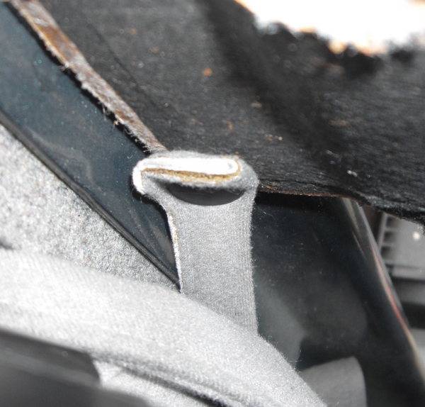

I also found evidence of an unwanted resident - a mouse - little bu**er had built a nest under the rear seat from some nice fluffy soundproofing and access through a neat little hole at the seat corner. Slight damage to seat, but not visible under normal circumstances. I think it's now long gone, but am thinking of installing a full-time cat in my cat to avoid further problems !!
The result : the JBL speakers were around £30.00 ($50 US) for the pair . They are full range with a built-in tweeter and passive low-pass crossover coil. I debated with myself about trying to sparate the tweeter wires and connect them in parallel with the existing mid-range unit, but decided that would be too risky. So, I'm actually "wasting" the tweeter but in the standard system, this wouldn't be an issue. The sound is actually very good - in my opinion, as good as the original Jaguar bass drivers. Enough power for my elderly ears, and an extremely quick, cheap and easy fix for an irritating problem. They will NOT satisfy the more discrimination audiophile who wants higher power and a better frequency response, but - you won't get that for 50 bucks !
