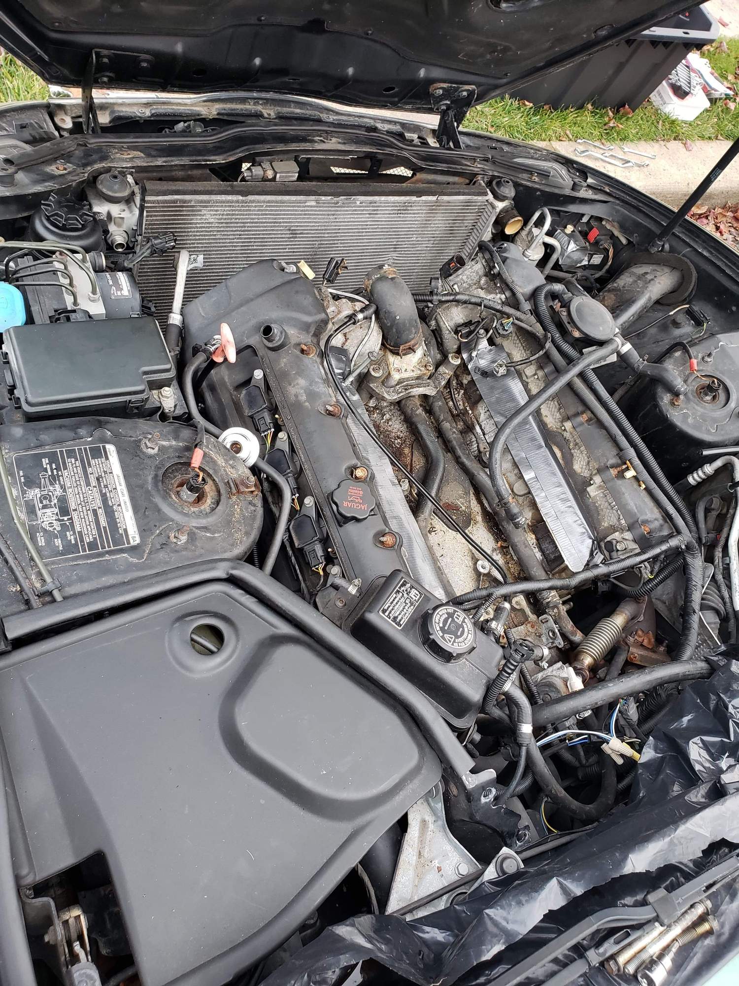

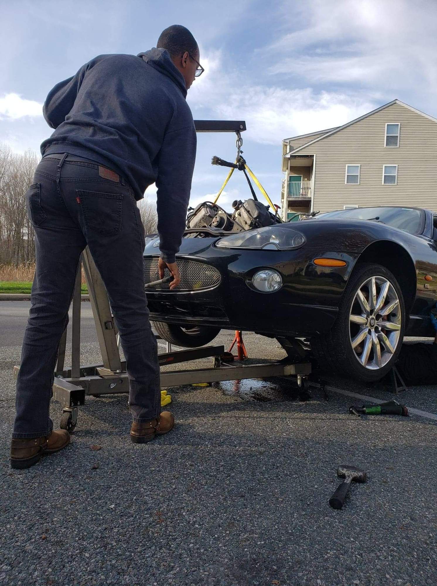

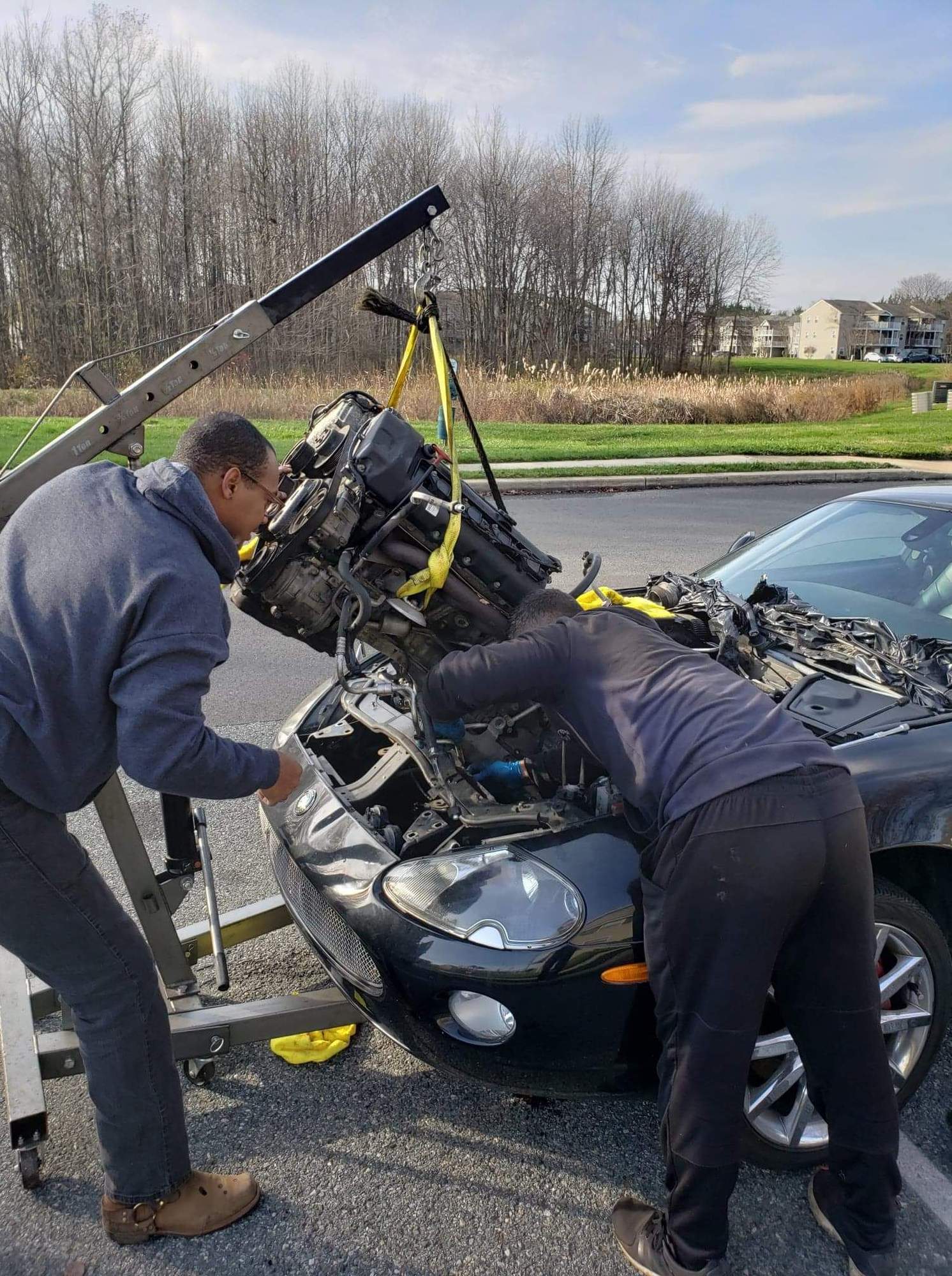

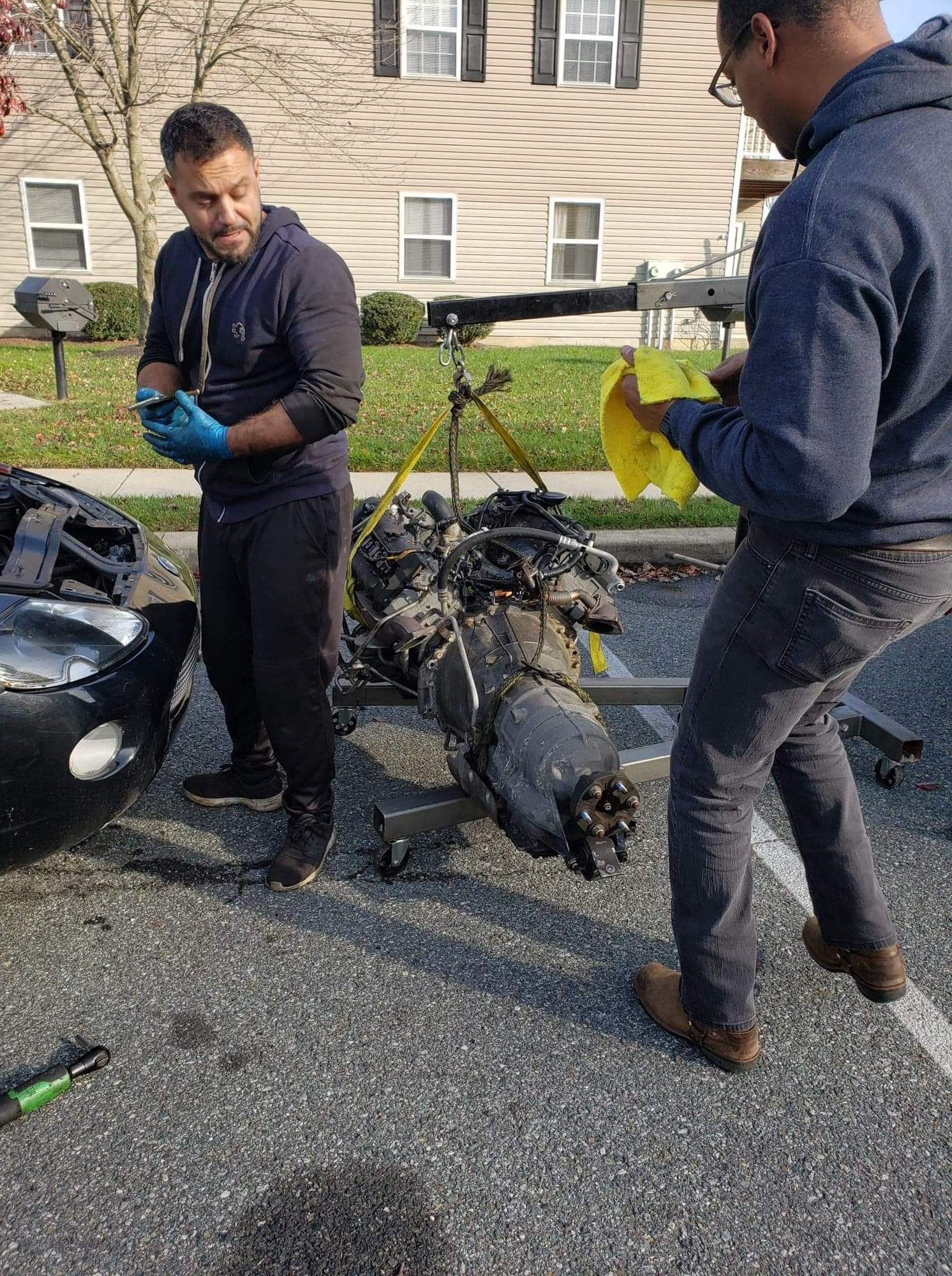

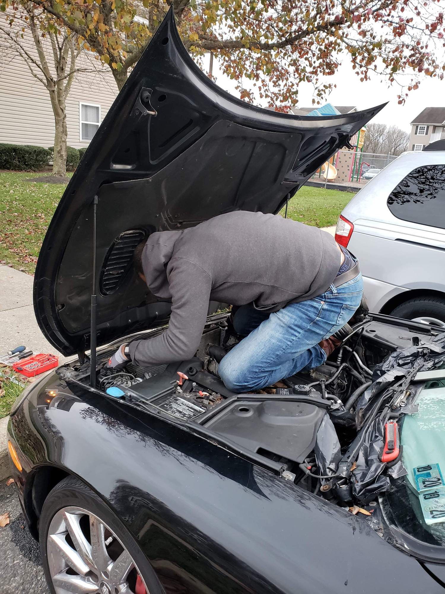

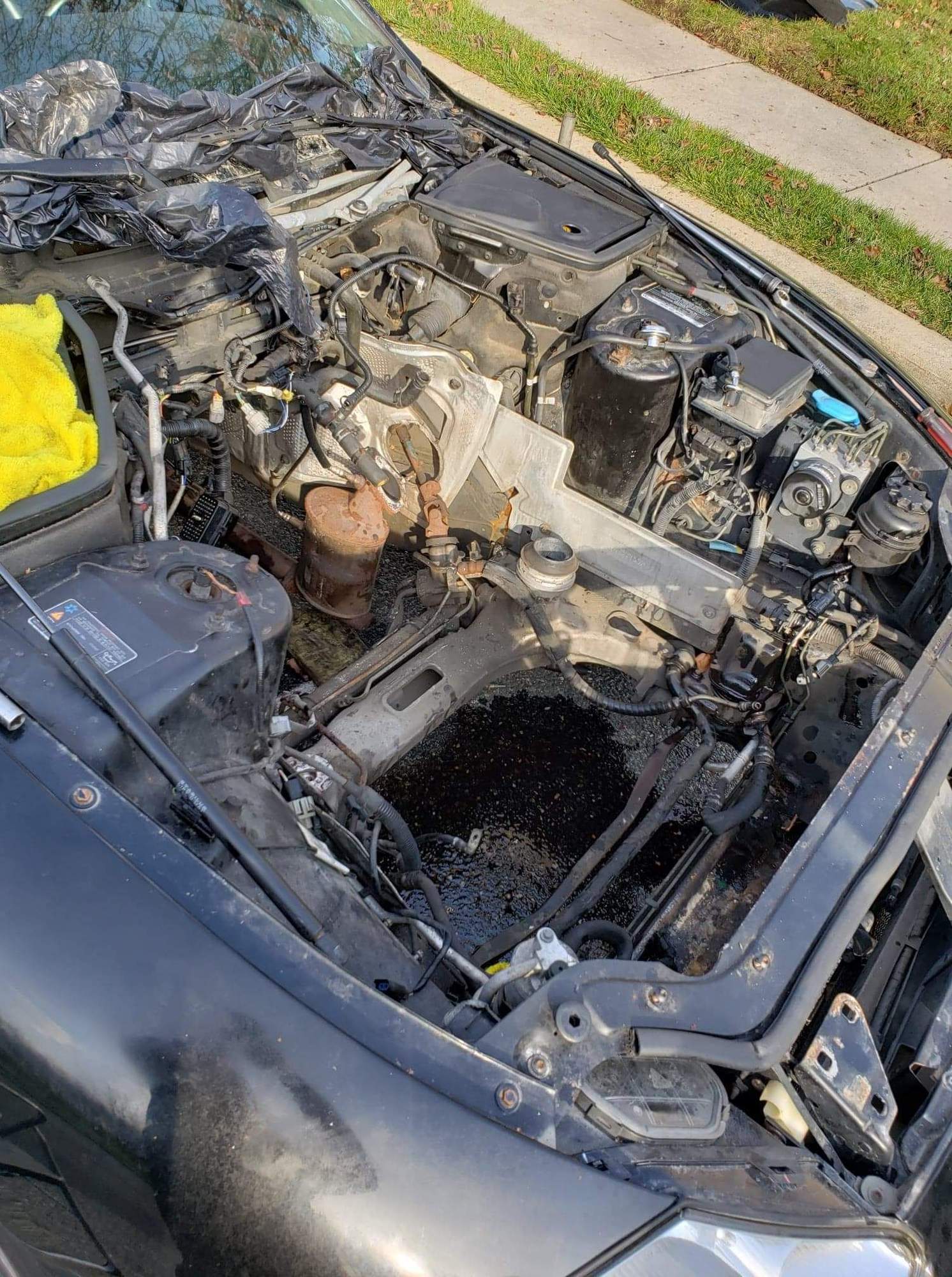

My manual conversion update
Old Dec 1, 2020 | 10:56 AM
Dwbridge87's Avatar
Joined: Sep 2019
Posts: 37
Likes: 11
From: Philadelphia Pa
Motor used. 98 4.0
transmission used. 04 s type 2.7d Uk
clutch used. nine yet
Flywheel used/built by. Tom lenthall
engine management used. megasquirt
pedalbox used or cluch pedal mod. xjs pedalbox UK
Old Dec 1, 2020 | 11:54 AM
