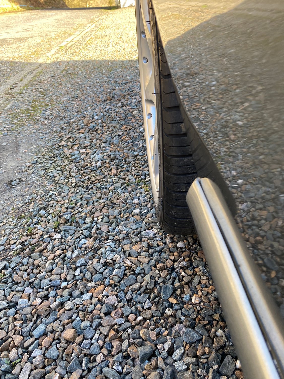

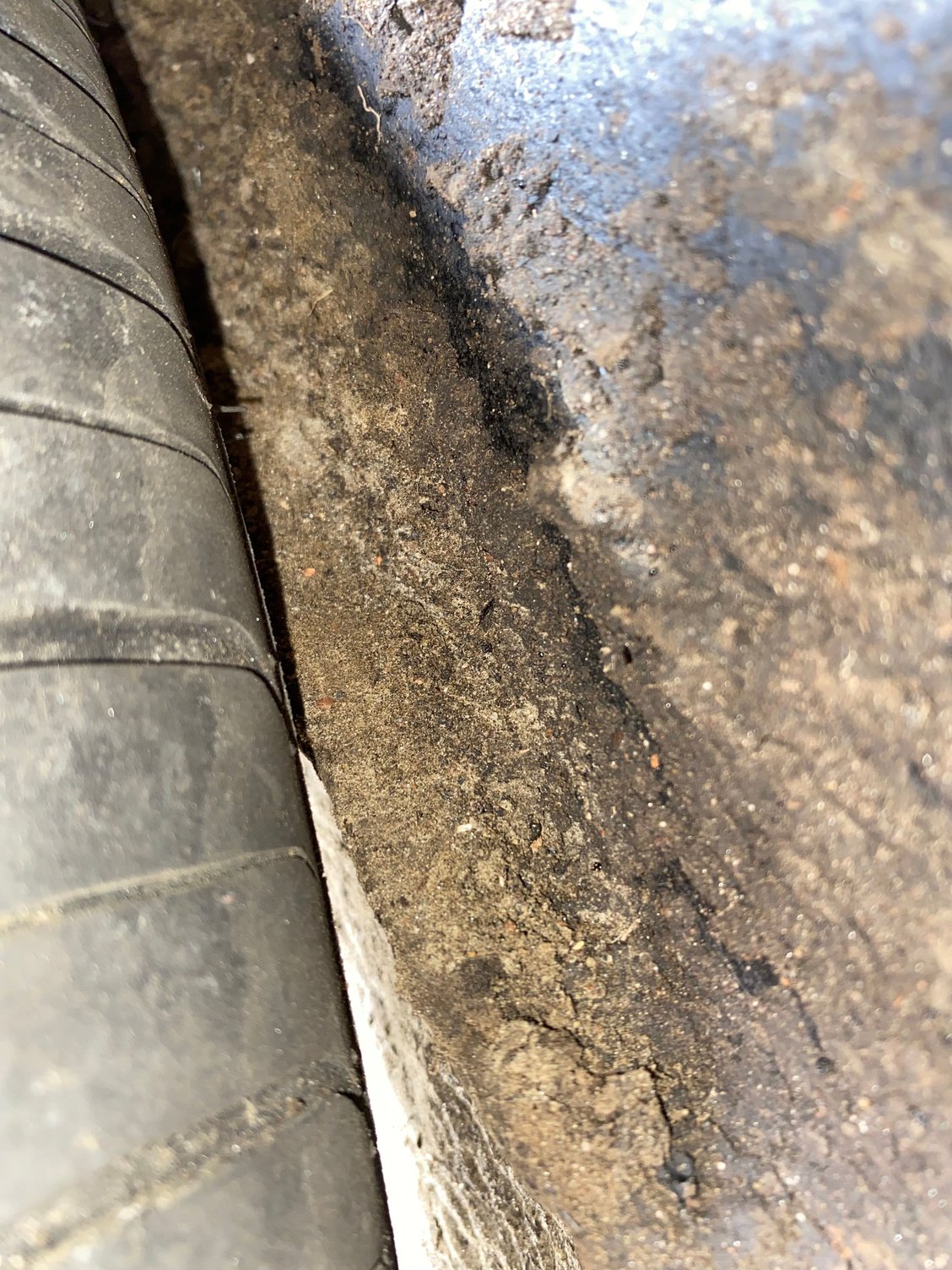

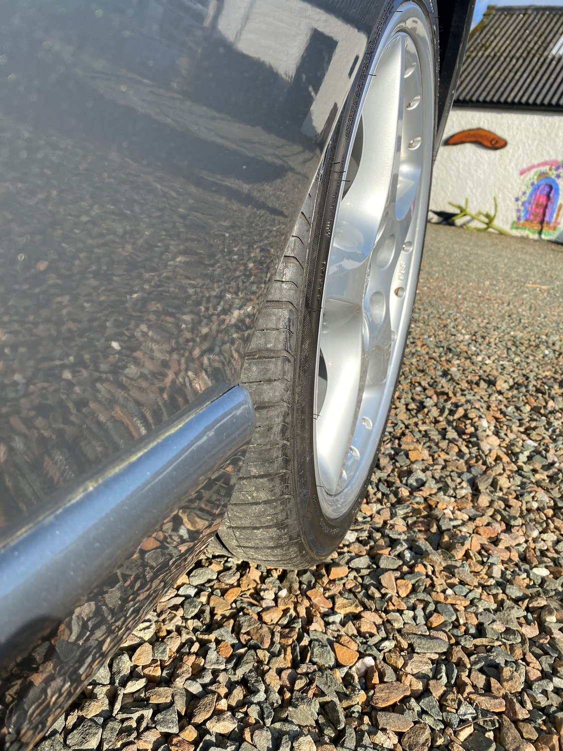

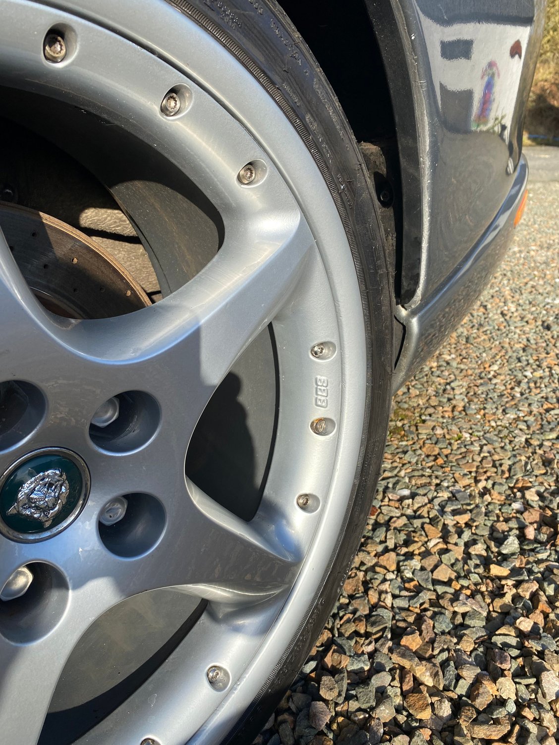

I’ve just had my detroit split rim wheels powder coated on my 2005 XKR x100. The car ran perfectly beforehand but, after refitting, one of the rear wheels interferes with the raised metal shroud that runs circumferentially round the inner wheel arch, see pic. The other side has a full finger space clearance. When I swap the wheels around, the problem transfers to the other side. My initial theory was that when the painter split the rim, he didn’t mask or remove paint from the mating surfaces causing the wheel inner and rim to sit apart, ie wider. This doesn’t quite add up because the rim fits together snugly with the inner wheel (no offset from the outside). The external appearance is the same for left and right hand sides. In any case, this wouldn’t account for a full finger width offset on the inside. I doubt even the titanium bolts would reach. I’ve roughly measured the wheel rim widths, which appear consistent on both sides- 26cm front, 28cm rear. Please can someone tell me whether the wheel rims are all the same on the detroits or is there something the painters could have done by mismatching the rims to the inners? Any other theories. I feel somewhat baffle or maybe stupid

Don't know but front and rear have different off sets...since they were taken apart maybe there was a mixup in assembling

That’s it. One of the fronts is protruding! This must be the one from the back.Do you agree? - need to be sure I get the right side!

30mm front, 25mm rear. Regards, Dave.

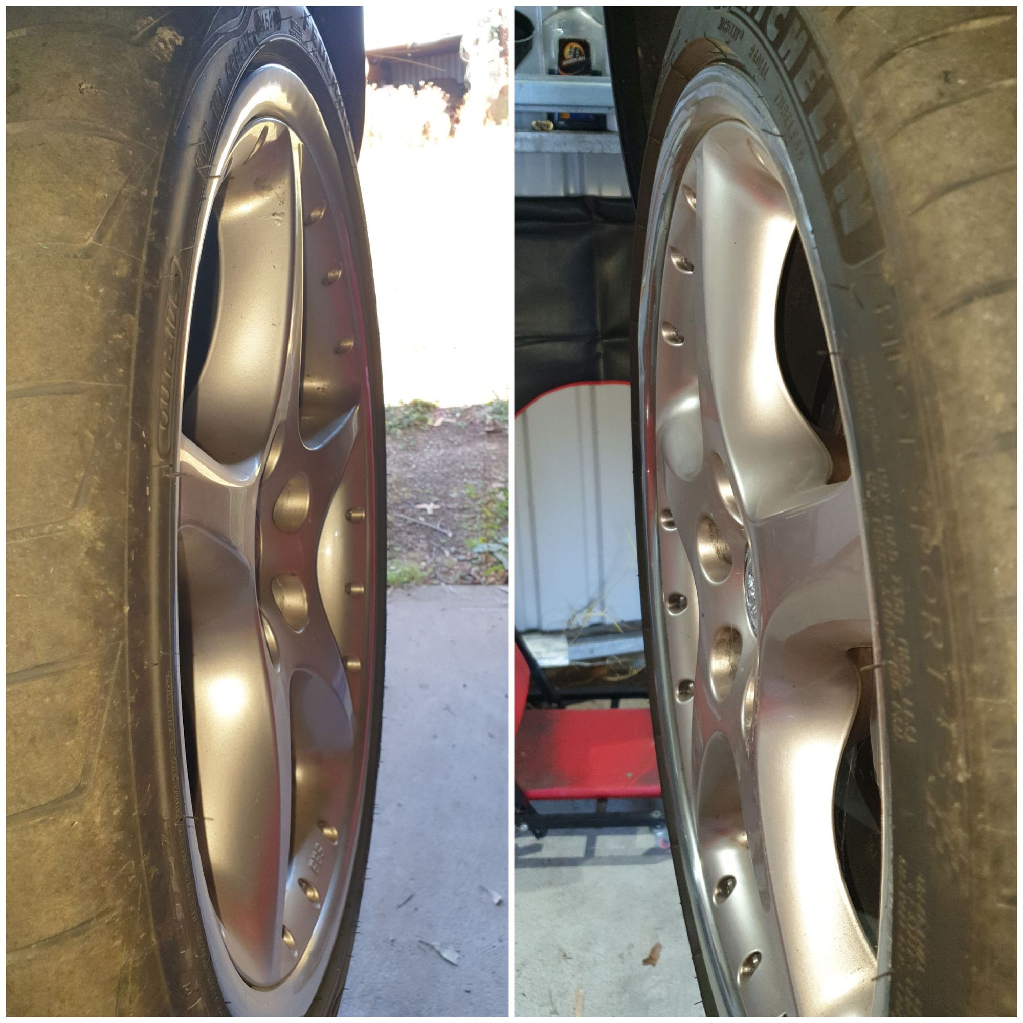

If that last pic is on the rear it is wrong, the spider is a front.
Rear is on left, front on right. Difference in back surface curvature is apparent.
