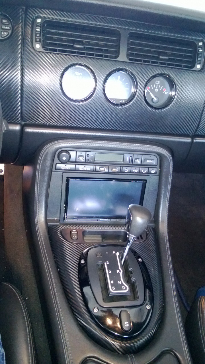

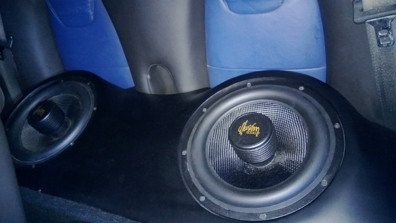

I put in a flip screen in my first XK8 and it hit the shifter if it was in park. If I were to do it over again I'd relocate the switches down and put the unit on top of them to avoid this problem. On my XKR I relocated the second row of switches first to the glove box (which wasn't convenient) and then to the center console (better). This worked far better. Granted that was just a start as I've since replaced the amps, all of the speakers, and replaced the rear seat with subwoofers. But the car sounds amazing.

OK that picture was crap, here is a better one. I also added a picture of the subs and the flip screen on the old XK8.
Attached Thumbnails Installing an aftermarket stereo on a stock amplified system-wp_20130318_009.jpg   Installing an aftermarket stereo on a stock amplified system-wp_20130608_021.jpg   Installing an aftermarket stereo on a stock amplified system-imgp0437.jpg

No shots, I had this done, but I did drop in and once the switches were relocated their was plenty of room. Not enough for the large screen Alpine which was a shame (would have had to relocate the second set of switches and didn't want to do that). Here is a shot of the switches.
Attached Thumbnails Installing an aftermarket stereo on a stock amplified system-wp_20130608_024.jpg
