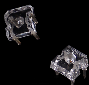

I had to repair mine recently as one of the retaining clips had detached from the rear window glass. From memory, there are about 20 LEDs, and they are similar to these devices:
